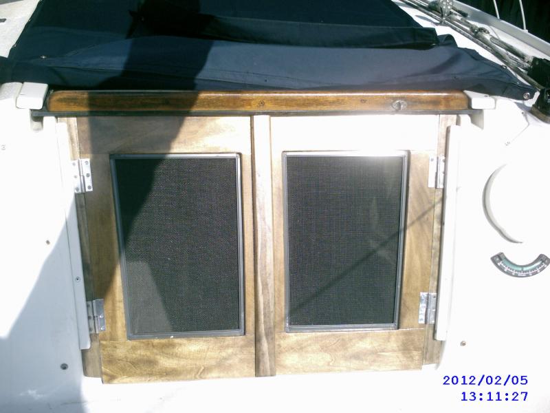

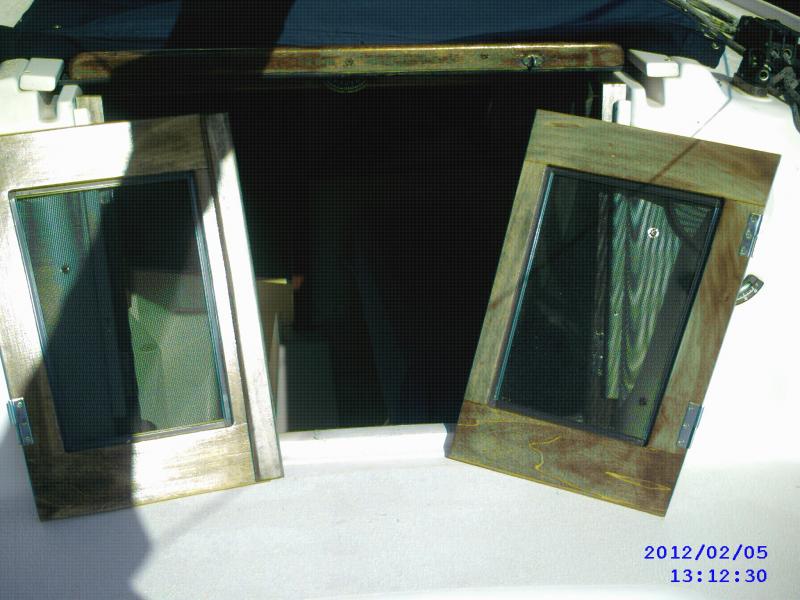

Made these for my 23.5.2 sets one with screen,one with plexy glass.Used split hinges so can just lift off and store when on water.The plexiglass ones siliconed in place,screens just used window screen frame mat at Home Depot in case screen rips can replace like at home .
