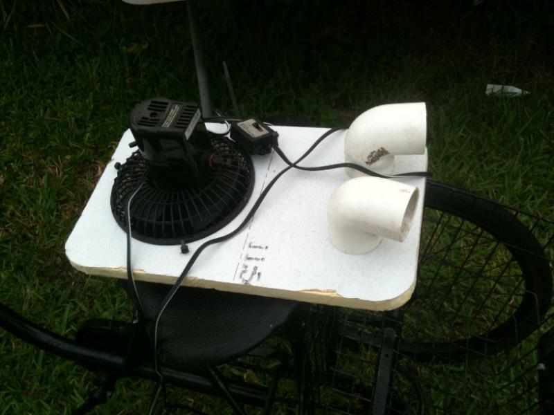

I actually made one of these and ran it in my daughters hardtop Wrangler for about 2.5 hours on a bag of 7-11 ice. It worked, not great but it was summer here and middle of the day. I don't remember how much it dropped the temp in the Jeep but it was livable inside. With more ice it would work longer and better.
I used an old cheap igloo, a piece of 1/2 blue insulation foam, (yard sale) 12v clip on fan and 2 PVC elbows as supply (exit) ducts (checked the garage and I still have the top- pic below).
I think the system Phil describes with a coil of copper in the chilled liquid and a car heater core would be much better AND if it were a closed system, you could plumb it to the boat's ice box. You'd need a small, low volume pump to circulate the water.
