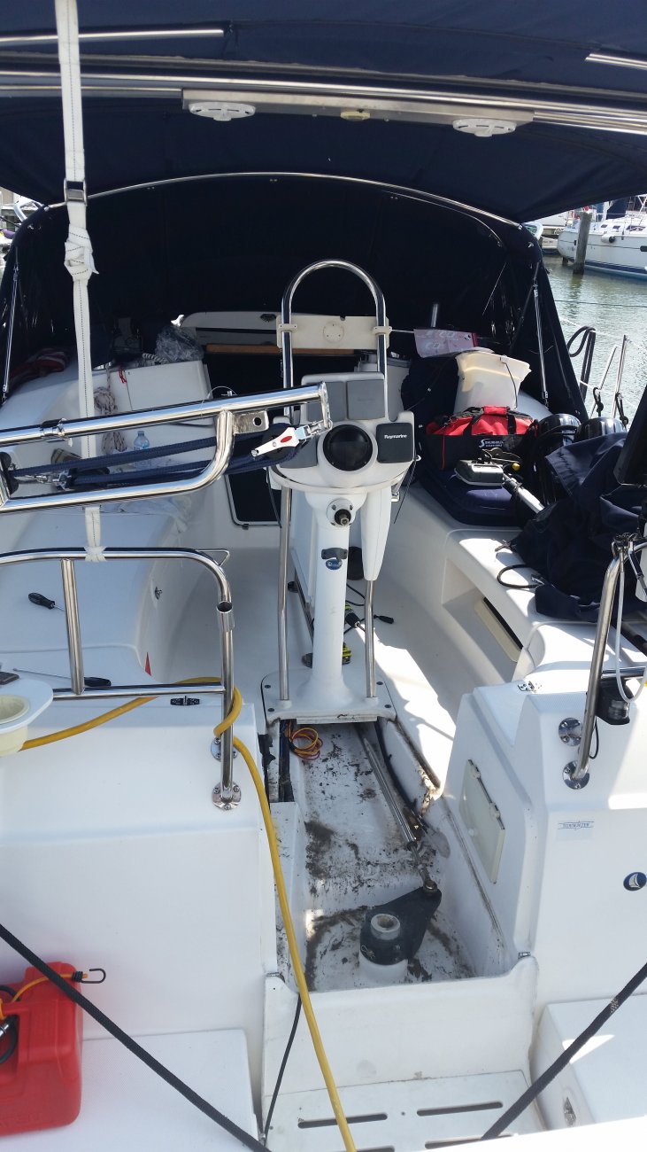

Yes, you need to take the cockpit floor panel up and in my case used the port side tube to run the cable up. Used the power for the P70 head off of the existing SeaTalk tie in for the ST60 instruments via SeaTalk/SeaTalkng connector. ACU is power wired to breaker in panel.
Don't have a picture of the lazarette but the EV-1 is under the shelf to the outside and the ACU is right inboard if that as high as possible. No interference from battery but I also have an Electroscan and have a 12 volt On/Off battery switch that is also on the front wall and when the Electroscan runs the autopilot does a crazy Ivan. I am adding a larger battery bank under the dinette and am rerouting that switch to eliminate the issue.
Picture of cockpit mid installation, see wires on left side.
