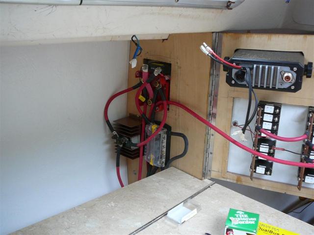

jrowan,
It is not original..the PO added it. When I did the fat cable re-wiring this spring, I moved it from the engine compartment (batteries were to port in engine 'room') to inside the chart table since I also relocated the batteries to the stbd settee..the isolator is now between the battery switch & the alternator output, which now has a dedicated run over to the isolator with 4# cable. It is one of those old Hehr??? diode based passive isolators. I also have an adjustable regulator on the Motorola alternator to compensate for the 0.7 voltage drop, so I can still get 14.2v to the batteries.
Here's a picture of inside the "in progress" chart table and re-wire project
