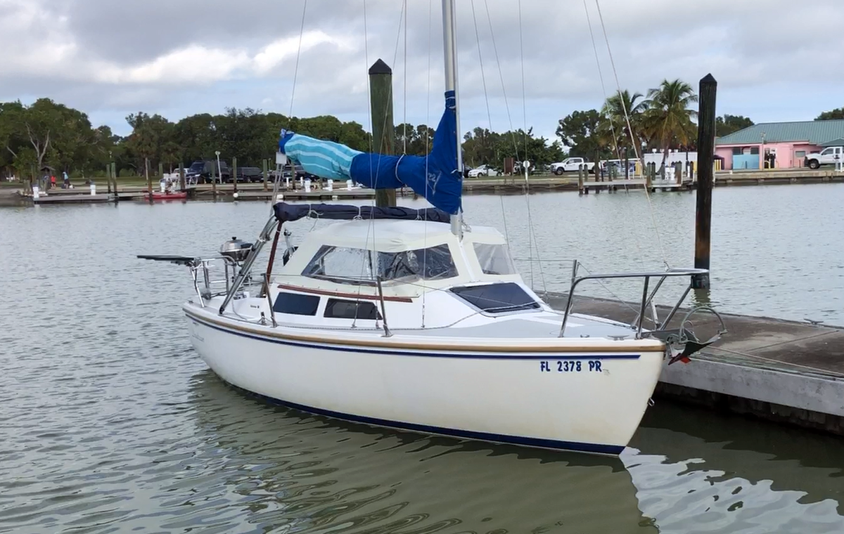

I guess I should have made it clear from the beginning that these C22 poptop tents are not Sunbrella. :) The material is a sort of laminate, with what I would call "pleather" vinyl on the outside, and some sort of fabric on the inside. It is the fabric side that mildews.
I own two of them, because when my wife saw a second one for sale, she made me buy it for a spare. Emboldened by this, I threw caution to the wind and just sloshed 50/50 bleach (non-detergent swimming pool stuff, stronger than Clorox) all over it. Scrubbed it hard, rinsed it well, and threw it over a clothesline.
All the mildew came off pretty quickly. No visible harm done. There was one spot where my wife had experimented with peroxide on it a few minutes before (which was total fail) that turned a little yellowish. Guess I should have rinsed off the peroxide before bleaching it, but at least the stain is in a place where it can't be seen.
