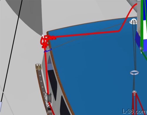

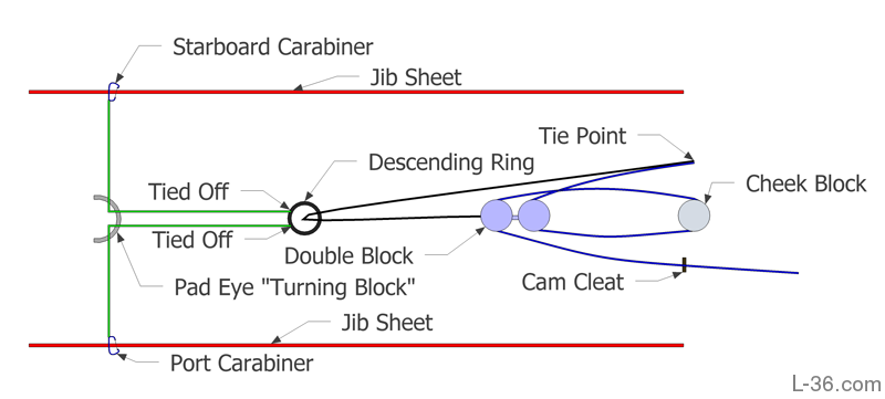

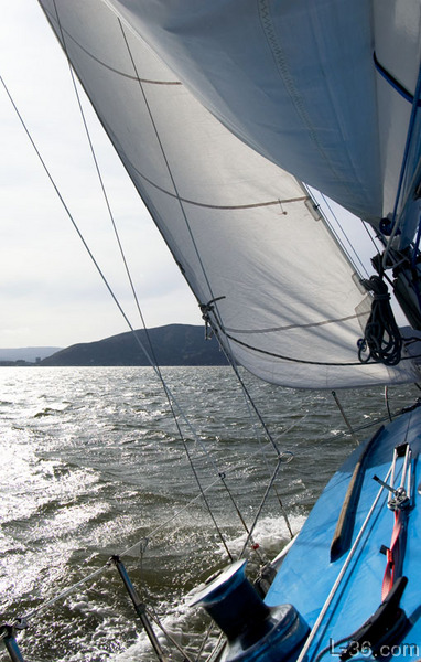

With toe rail sheeting on my boat, and a preference not to install a jib sheet track next to the cabin top, I have been wondering about an in-haul setup like in the attached pictures. (copied from l-36.com/inhauler.php)
Does anybody have experience with the practicality of it?
While undoubtedly the arrangement will do the job of in-hauling, what I don't know is how it performs in actual use of tacking frequently. When the jib is flogging a bit and/or the jib sheets are slack during the tack, how severely does the setup trash about? And can the carabiner line and the sheets get twisted into knotted tangle?
Maybe this is practical is only for longer stretches on a single close-reach tack? Or if enough people are on the boat to tend both sheets during tacking to be sure that the sheets don't ever go too slack?
Thanks
kenn

You could modify to reduce chafe and friction by shackling a couple of blocks to the forward ring.... or just one block, with a single barber hauling line that you switch back and forth between the loaded sheets as needed.
Quite frankly, you'll find many variations on the barber hauler rig.. some pull out, others will pull in.... On my Cat 27, with the large headsail up, I can in haul with a carabliner equipped line from the sheet to the windward halyard winch on the cabin top. It's a lot quicker than running a second sheet to the inside track....
I might suggest you experiment with the cabin top winches, if you have them, in the manner that I mentioned. The deal with your example is that it's a small headsail and the clew is well forward, that's why they have to resort to placing the pivot ring forward of the mast.... Your sailplan may require it be further aft.
When I use mine, I don't tack back and forth with it hooked up... with my 110 or 135, it's very convenient to reach up and unhook it before I tack. Then on the new tack I can change winches and re clip the line on to the new sheet. This is what I would suggest you do... even if you're racing you're going to ease the jib a bit before tacking.... so unclipping the barber hauler makes an allowance for that slight bearing off maneuver before tacking.
If on your much larger boat you find you're not comfortable hooking and unhooking it for each turn, and desire a bit more permanent set up, then by all means go with your diagram..... the big decision is where to put the pivot because its position is determined by the clew location of the sail you'll be using.

To make such 'in-hauling' (barber hauling) easier and simpler, if possible set the barberhauler lines parallel to the horizontal so that they ONLY pull along the horizontal plane and do not add any vertical force. Any vertical force would change the fore/aft tension of the angle from the 'farilead car'.
The 'best' way to use a barberhauler is to only adjust it AFTER all the tell tales on both jib and mainsail are flowing 'perfect'. Once the tell tales are flowing 'perfect', then only ascertain the amount of barber haul needed by watching the SPEEDO, and ignoring any 'so-called backwinding' that occurs in the mainsail. Pull in or ease out on the barberhauler to get maximum speed or to get maximum VMG. For easier usage, put marks on your barberhaul control line and record at which mark you got the best VMG output vs. wind/wave conditions so you can easily 'return' to that setting at later times, etc.
Hint: the lower the apparent wind velocity the closer 'in' the barberhauler; the higher the wind speed the 'further out' the barberhauler.
Then learn to 'turbo sail' ----- Once you arrive at perfect shape and trim, including barberhauling for the day, then consider: http://forums.sbo.sailboatowners.com/showthread.php?t=128753&highlight=footing post#12 "Footing off" to gain more 'lift' from the sails and keel for optimized 'pointing' and getting the keel to 'lift to windward' when pointing.
If you find barberhauling to be an advantage, you can later add a second jib track, or 'radial' line controlled cross-deck traveller for the 'jib cars'
