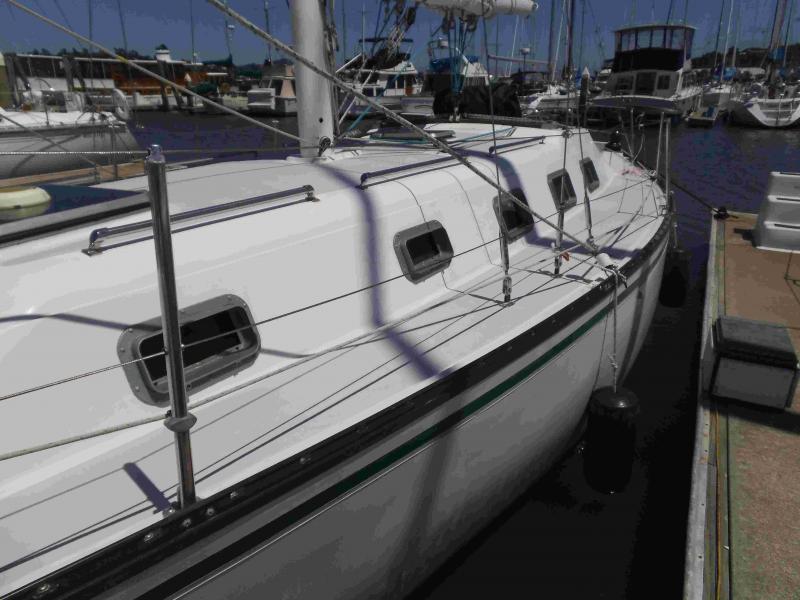

My 1980 Cherubini 36 was originally delivered with toe rail only jib sheeting. I still do it that way. Depending on the jib size, amount unfurled and wind speed, snap blocks are simply moved forward/aft along the toe rail cut-outs.
What other Cherubini models came without inside (next to cabin top) jib sheet tracks?
Has anybody made the conversion to inside track sheeting? Was there a perceptible performance improvement up wind -- or not?

Great your boat points so well with the toe rail sheeting. If your current toe rail blocks are fixed at one point, seems that you have one sail and also that you don't roller reef it?
My boat when I bought it seven years ago still had the original snap blocks! Actually three of them. I have stowed them away however. Instead I converted a couple Schaefer standard blocks to easily move along the toe rail by the addition of swiveling type snap shackles like per these:
http://shop.torresen.com/ships_stor...e=Snap+Shackle+Large+Bale+73mm&sectionid=5111
Or Garhauer sells single blocks already fitted with snap shackles for quite reasonable $'s as on this page.
http://garhauermarine.com/catalog_process.cfm?cid=16
As for adjusting the location while under sail, yes and no. It can't be done safely while the block is under load which is the case in any wind more than amost dead calm. Generally I adjust only when changing the amount of head sail furled. But sometimes also when I notice that the leech might be too tight vis-a-vis the foot or vice versa for the wind velocity of the moment. First I will move the lazy sheet block to the new location on the toe rail. Then take in or let out the sail. Then tack. Then mirror the new lazy sheet block to the same location as the other one.
Another variation I've done is add a second block to the toe rail on each side further aft close to the primary winches. The gives a better lead to the winch and ensures that the sheet is connected to the boat at all times.
