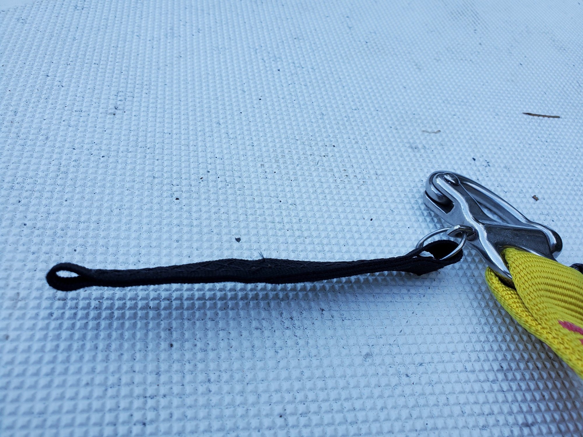

Went for a solo sail Saturday in rough conditions, making sure to wear my tether. At one point I looked down and saw it had come unclipped from my life vest :yikes:. I took it as a good reminder to not rely on it to catch me. Not sure how or when that happened.
I use the kong tether:
Just this morning I saw this article in my newsfeed:
The title says "tether snaps," but the article says:
"My tether snap shackle at the chest, for whatever reason, sending me into Lake Michigan in the middle of a thunderstorm "
I don't know what that means exactly. Did it break or open like mine did?
Anyone else experience the quick release tether shackle accidentally opening?

Look at the looped lanyard on that tether. Easy to pull as a quick release, and easy to snag on something, which is certainly what happened.
I would remove that and replace it with a knotted lanyard or a bobble. A loop, or any lanyard that is easily snagged, is a bad idea. I have a very short lanyard on my Wichard Proline. My other tethers have locking hooks on the harness end.
Personally, I have mixed feelings about quick release tethers, specifically for solo sailors, but that is a separate topic.

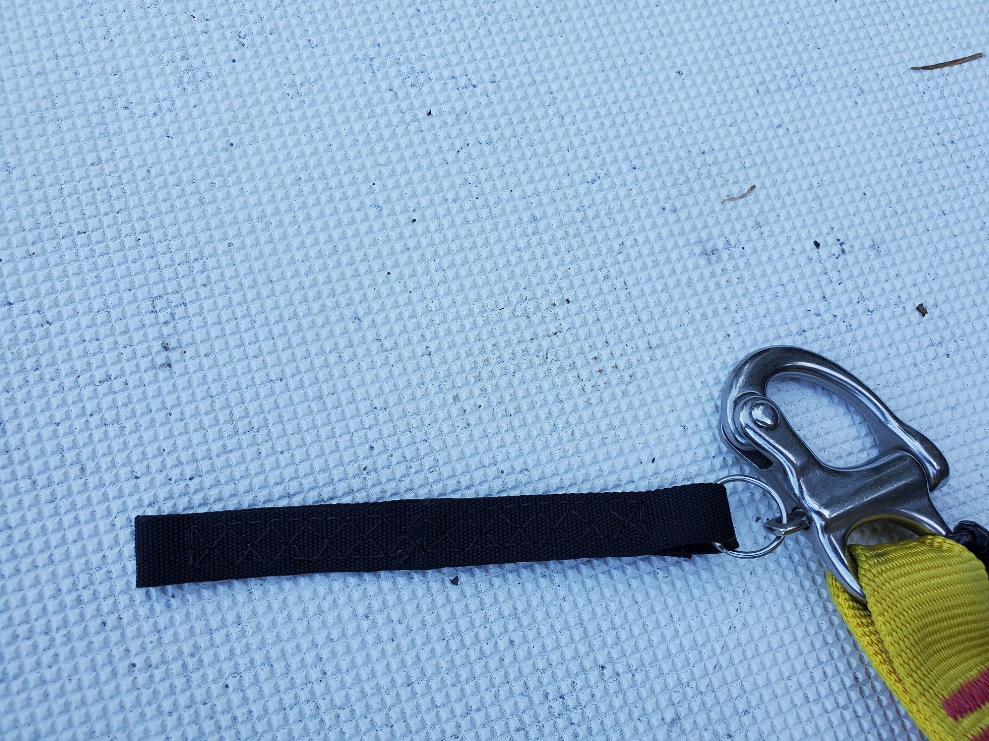

I checked the lanyard. It's sewn flat so I doubt it caught anything. Maybe the ring snagged something?

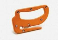

Now how do you deal with an emergency release?
I am going with these on all of my PDF's...
At about $10 a piece they are an inexpensive, safe cutting tool designed to cut webbing (like a seatbelt). :biggrin:
Will work on the tether webbing or jack line webbing. With the blade shielded less likely I will cut myself as with a knife while dangling from the life lines.
Now for some practice time.:yikes:
I don’t know. The blade may rust if not SS. What happens if it does not cut through the on the first swipe? Do you have free it and try again? You may be confined to an “overhand” cut, it appears. With a knife you can cut overhand or underhand; whatever is best while you’re dragging/twisting alongside the boat, etc.:yikes:

The particular safety knife can be opened up and the blade replaced. Like everything you need to inspect and maintain your tools. I always carry a knife as well. Just not sure it will be as useful as the safety knife upside down hanging on the sides of the boat.
