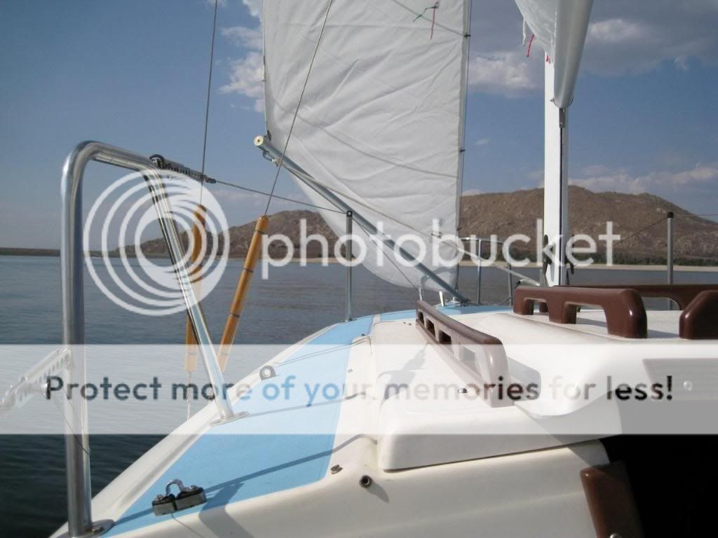

Ha!
I bet some of you thought thought the hand rails on top of the pop top slider were just for looks.
Not so, they are for going foward when the top is up and the boat is bouncing all around, or when it is calm.
