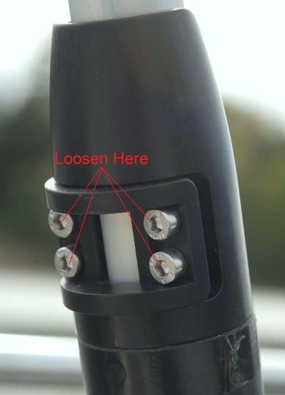

Step one: Loosen these four bolts and pop the retainer plate out off the corresponding notch on the foil (you do not need to take them all the way out, just loose, a NICE feature to prevent losing the bolts):

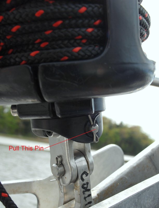

Step two: Remove this pin and slide the drum up the foil and snug down the previous four screws to hold the drum up and out of the way:
