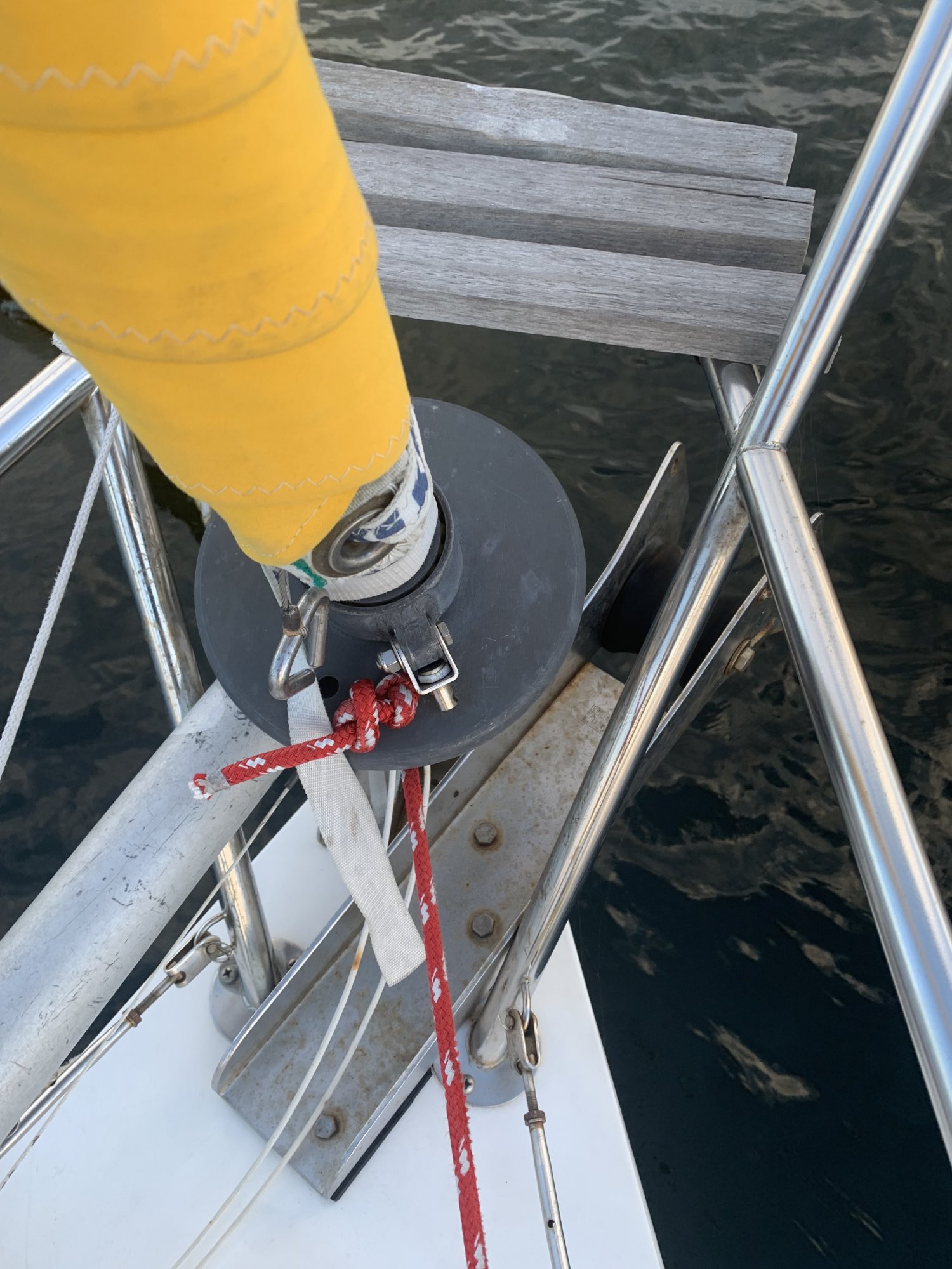

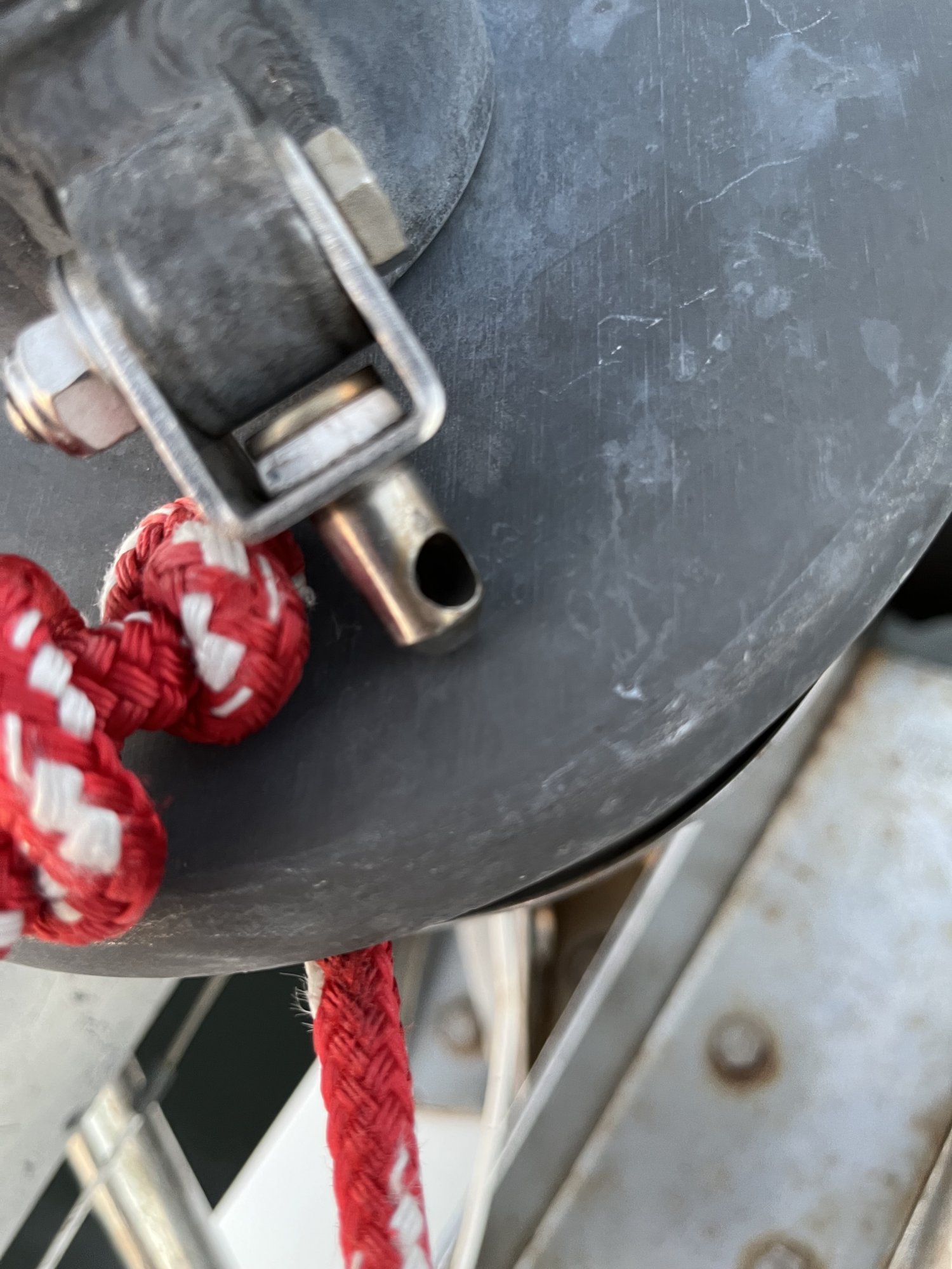

Lost my shackle to the Harken MK1 Furling Jib that connects the drum to the tack. I known the diameter is 1/4 inch for the pin. I need to know the rest, Does anyone know
Thank you
