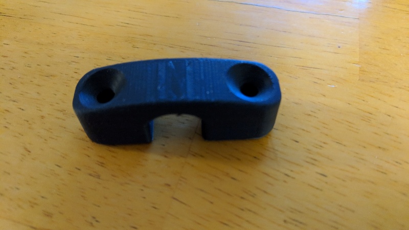

fairlead.jpg Clearly, my part isn't hard to get, but I came by it in a way that's new to me.
My son heard me saying I needed a couple new fairleads. The idea is to keep the outhaul line from sagging below the boom if I release tension on the line. He suggested rather than ordering them he could just print them on his 3D printer. The photo is the raw fairlead before I clean it up to mount it. I thought it turned out well. other small parts like the supports that hold an st4000 to the wheel could be done the same way. I'm wondering if others have been doing the same?

That is slick. Now the big question, how much did it cost you - time and materials? 3D printing has a lot to offer but I've often wondered about the actual economics of the whole system.

How long do you expect that part to last? What material was used? My company plastic prints prototype parts all the time. But they are fragile and not UV protected. They don't last very long, but that's OK.

It took the printer just under 3 hours to print it. The ABS filament is (I think) about $23 for a kilogram (2.2 pounds). This makes the material cost really low. I have no idea how long it will last, but the fill is solid. In terms of UV, for direct sun exposure, it should be painted, but I'm hoping the black color will help prevent UV from passing through the outside surfaces. For my purpose, it doesn't need to be strong and it will be under the sail cover when we aren't sailing, but I think I'll still paint it. The biggest problem is it needs to be designed on a CAD program then transferred to a printable file. My son did that. If you look online at https://www.thingiverse.com/ there are a ton of files others want to share for free.

ABS without uv stabilizers won't last long in the sun, and darker colours absorb more light.

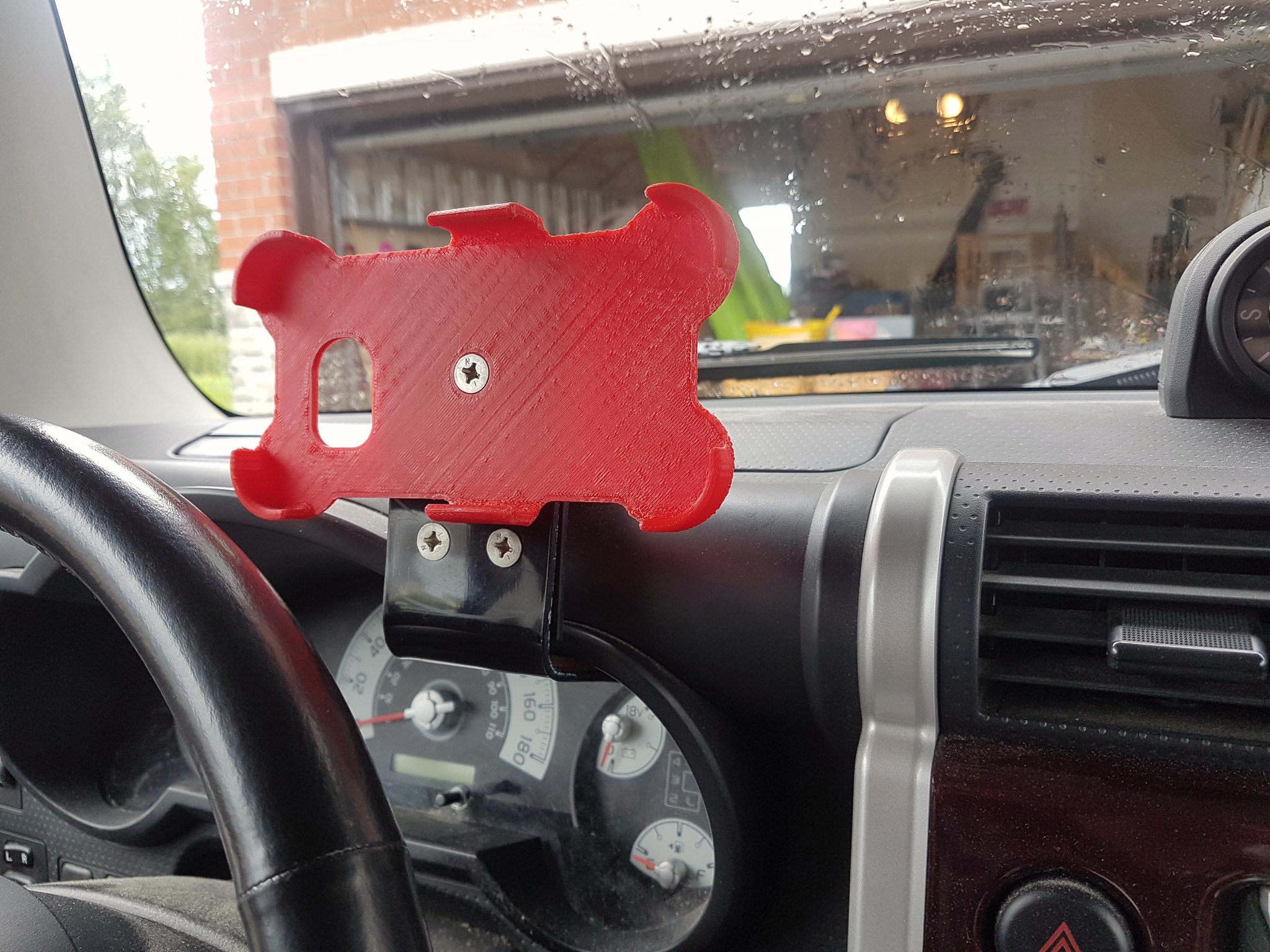

I like to make stuff with 3D printers and I've been using them for about 12 years at work. A lot of the standard plastics used in 3D printers are not great with UV, some better than others. I have a car phone holder that I printed about a year ago using PLA that is starting to warp. It was one of the first things I printed with my home printer and PLA is easier to use than ABS. This holder is about end of life after a year and I'm going to try it using ABS to see how that goes. As a comparison between plastics, I've been using the bracket for this holder (black part in the photo below) for about 6 years and just changing out the holder when I get a new phone. The black part is heat formed sheet, Xenoy X5300WX, which is a UV stabilized plastic and shows no sign of degradation. The red part printed in PLA is done after a year.
At work we have an industrial machine that prints ULTEM 9085 which is much better than PLA or ABS for many properties including UV resistance. Black, although it does absorb heat, actually stands up better than lighter colours because it blocks more UV transmission to the part interior. Even so, you won't get as long a useful life as parts made with UV resistant plastic. Another consideration is the initial strength of the part. Most home 3D printers fuse layers of plastic together by melting in a process known as fused deposition modeling (FDM). These parts just are not as strong as molded or machined plastic parts especially in the Z direction (height when printing).

Seems a lot of work to print, clean up and paint a fairlead that you can get for $3-$4 made from tougher, UV resistant material.
I get the point though. Some parts are just not easy to find. The modeling will still be the challenge
