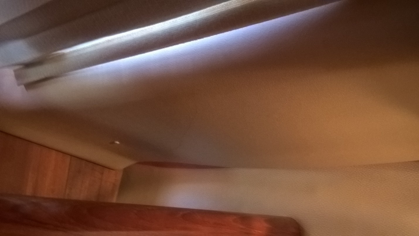

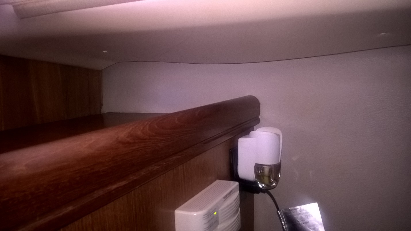

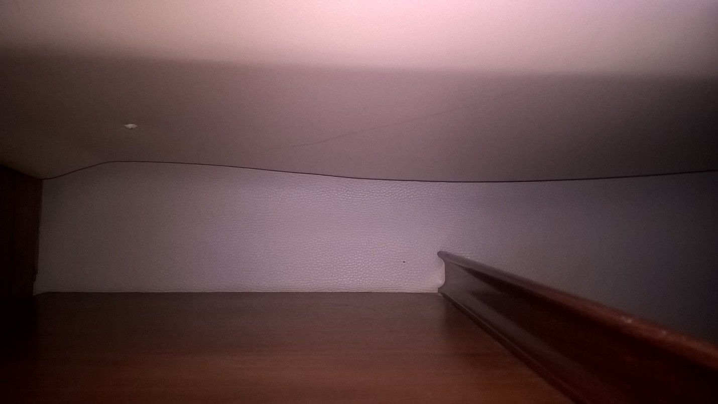

(2004 H36) I recently developed a leak coming from the hard cover over the locker in the aft cabin. I need instructions/suggestions on removing this cover to expose where the leak is entering. Thanks in advance for any and all assistance.

Here are 3 views of the hard plastic headliner I need help removing.
Oct 19, 2017
7,988
Are those buttons plastic press buttons or painted metal screws? They look like plastic press buttons, in which case, you will likely need to replace them after pulling them out.
It looks, to me, like those two buttons hold it in place from swinging down and out of a slot on the inboard edge.

Does it look like a plastic cover over a screw head? Could not tell from photos. If I cannot help I will refer you who knows

If those are "standard" caps over the screws, then: The caps are simply trim. Take a screwdriver and GENTLY pry the cap off from the edge, it should snap off (it's like a plastic "mushroom" cap). Then it will expose a screw head. There will be a special washer that actually engages the cap. Don't lose the pieces, you can then reinstall the caps after you reinstall with the washers in their places.
The liner may be attached with some velcro, or various other methods.

They are painted metal screws.
