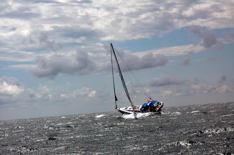

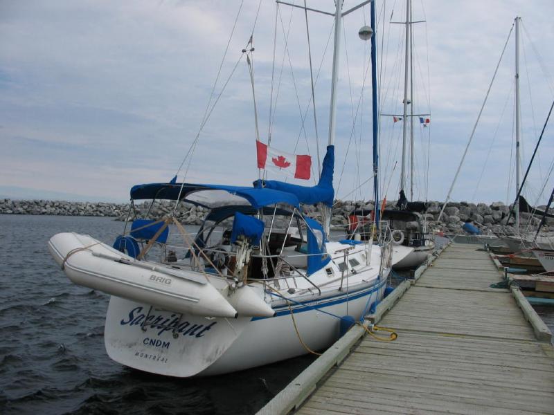

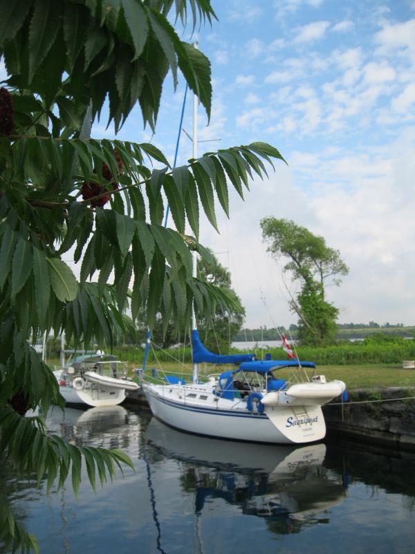

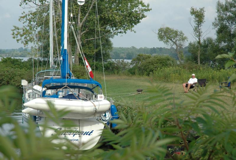

Once you fix the leak, I have found a way to hoist the dinghy behind the boat. Suspend it from the top of the mast !!! When you're done laughing, consider this: I ran a halyard in the mast using the spare sheeve next to the main halyard sheeve, (both on top and on the bottom of the mast). I made a sling with safety belt material and attached 4 hooks to the 4 arms of the sling. 2 hooks are attached to the dinghy transom (I installed eyelets) and 2 hooks are attached to the D-rings each side of the dinghy bow. For better support I also have a piece of sling going from side to side under the bow so it is not supported just by the D-rings.
I have brought the halyard to the cockpit and use the winch on top of the cabin to hoist the dinghy. Once where I want it, at the same height as the top of the stern railing, I secure the dinghy bow and stern to the railing.
Take a look at the attached pics. I also have a few videos (filmed on the lower St.Lawrence river, under 42 knots, no main just about 40 sq. feet of jib), but can't seem to upload them.
Safe under all conditions, I have had that system for 6 years now and have not had a problem ! And... I'm now smart enough to leave the dinghy drain plug undone when hoisted so that it does not get filled-up with rain water.

Wow. That just seems like a really bad idea. It goes without saying that your rig wasn't designed for a load like that. Oh well, your boat, your rules. Good luck and stay safe.

Robert, the soft bottom 10' dinghy weighs less than 100 pounds including the plywood floor-boards. What do you think the load on the rig is when sailing in 20 knots of wind ? Far greater for sure !!! As mentioned 6 years since installed, but 10,000 miles in those 6 years, with trips to Labrador, Magdalen Islands, and the Bahamas under all kinds of conditions. Not one problem ! I never have done it, but feel I could probably leave the OB on it as I have tested it by getting into it while at the dock. So far, the only real drawback is the same as davits. I have to lower it out of the way if I want to use the swim ladder. I can swing it to the side of the boat, but it gets tricky because of the bimini. Good luck with the up-coming hurricane

Yes, and that far greater load is distributed fairly evenly over the entire length of the mast and boom, while what you have done is add a concentrated point load at your rig's weakest spot, particularly if you have a fractional rig and the forestay does not offset the pull from the dinghy. I'm no naval architect, just a plain old engineer, but I have this uneasy feeling that what you're doing isn't a very good idea. Just because you've gotten away with something for a while doesn't mean it's safe. Anyway, like I said, I'm no naval architect. Maybe there's enough excess margin built into the spar cross section to handle a load like that. Maybe there isn't. I don't know. I doubt you do either. I am fairly certain that it's something the original designer of the rig never considered or planned for. And that makes you just plain lucky in my book. But as I said, your boat, your rules. I'm not saying your wrong, I'm just saying it's something I'd never ever even consider doing, much less recommend to someone else. Maybe eventually someone with more rigging or design experience may weigh in with an opinion. Now I need to go get ready for a hurricane...

WOW, a lot of people have been risking death and destruction when using a bosun's chair attached to a halyard. Concentrating their body weight (I'm at 230) on the "rigs' weakest point" is surely asking for trouble.
Robert, I must ask if you've ever heard of heeling a boat using large water bags? The bags weigh much much more than a 100lb dingy and are also attached to a spare halyard.
sample video: http://www.youtube.com/watch?v=epz6BBZm__0&feature=player_embedded
Claude, if you haven't noticed, I like the idea and plan to give it a try on my boat. I've never been one to worry about the sky falling.

I might be able to shed a little light on this........
The in mast sheave is arguably the "weakest point" As the compression strength of the mast is enough to counteract the tension in numerous shrouds and stays.
Be it as it may, the lowest working rating I see in the harken catalog for that size and location would easily convince me that the working load for the masthead sheave/pin system has the capability to support the dinghy bouncing around,
and without going into trig/vector analysis.... and looking at the size of the pins and rivets and welds in my mast. .....
The 5000 lb working load lead fixed block rating on the end of a 60 ft dacron, vectran, dyneema line is easily within the capabilities of the mast.
I wouldnt hang a motor from a single line suspended dinghy, but the weight load is almost insignificant to the rigging loads. I would suspect the weak link would be the clutch block holding the line, or the riveted cleat the line is tied off to.
The mast is not going to deflect significantly nor should you worry if properly tensioned, nor the halyard, nor the sheave, nor the webbing for the dinghy.
and yes I am a trained Engineer. The dynamic loading a rigid dinghy would apply to a single line in tension is within the working loads of the components. IF you have a 7/16- 1/2 " halyard you are fine. Dont use a steel cable.

Since I originated this discussion about suspending the dinghy from the mast I'll go on record as saying to Robert that I never recommended it: I simply said that's what I did and explained how I did it. And I also said I did not leave the OB on the dinghy.
That being said, I worked for 10 years in the polyester and cordstrapping industry and became very familiar with dynamic load forces in many types of environment including impact testing at the Association of American Railroad (AAR) testing center in Pueblo Colorado.
Waternwaves, for your info, the pins on the mast sheaves are 3/8", the line is 7/16", going through a back-plated deck organizer with 2" sheave and through an Easylock line stopper which is through-bolted. I really feel the Wichard shackle at the end of the line is probably the weakest point and I'm not worried about it. The suspended dinghy doesn't bounce around since it is also secured front and back to the stern railing.

Loved your pix and your solution. Very simple way to boat a dinghy...

Thanks for setting me straight on my ridiculous concerns, your snark really added much to the discussion. Wait a minute, it just occured to me - when you go aloft in a bosun's chair, your weight is applied in column. And those water bags - I'll bet you apply those loads laterally, in the same plane as all those shiny wire thingies that hold up the sides of the mast. But I'm sure you're absolutely right. Pulling backward on the top of a thin aluminum tube at a point eight to ten feet above where the forestay connects is probably exactly the same thing, right? I mean, what could possibly go wrong.
See, I can do it to. Now we can talk about the differential integration of the vector analysis of the designed load rating blah blah blah, but let me ask a more basic question to put it in perspective. How hard can you pull backward on the top of an unsupported, thin walled aluminum tube before it yields? That's all I'm saying. My gut tells me if it's a masthead rig, it's probably fine, but if it's a fractional rig, the margin to failure is probably closer than you think. That's my view of the matter.
