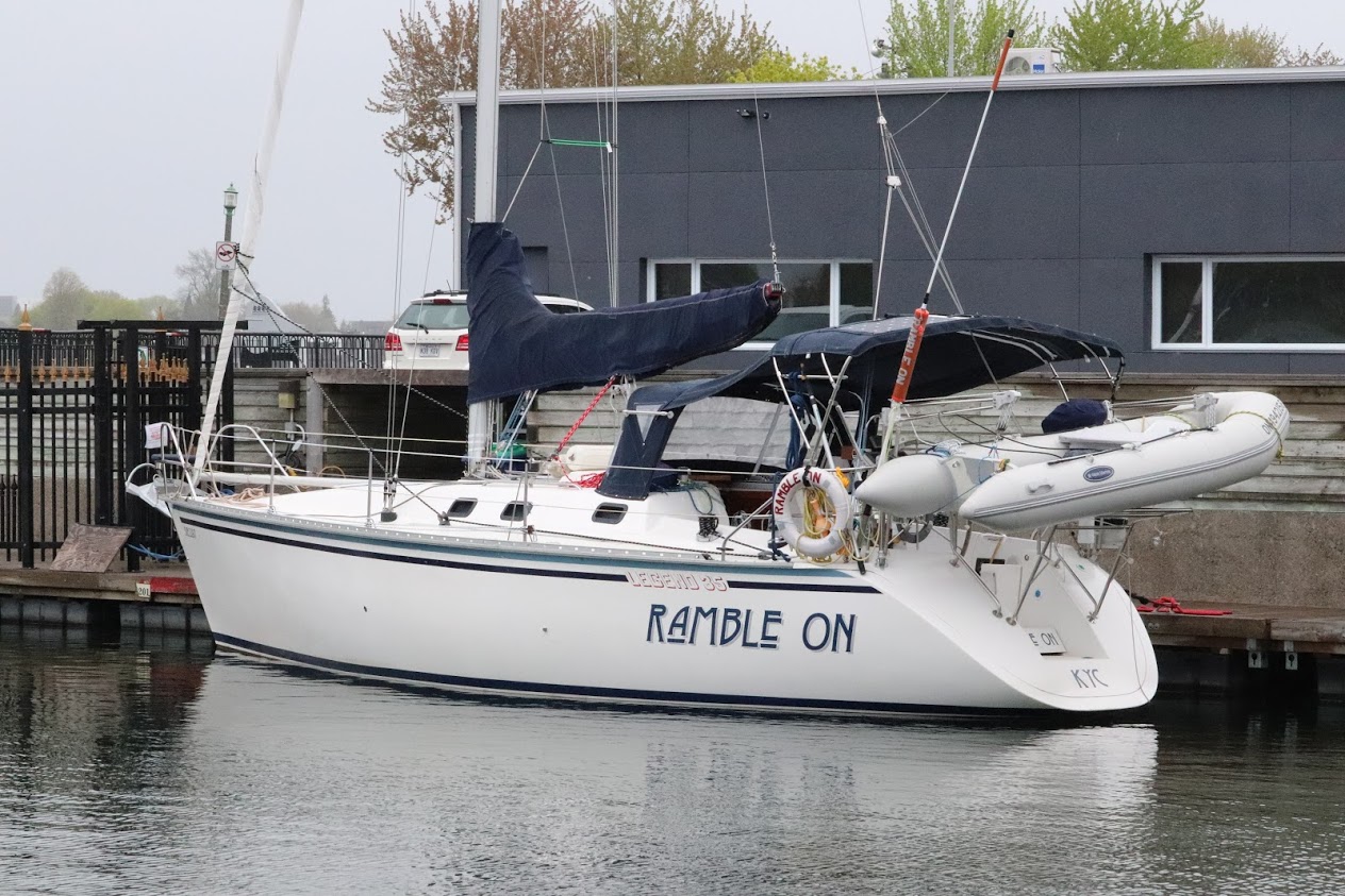

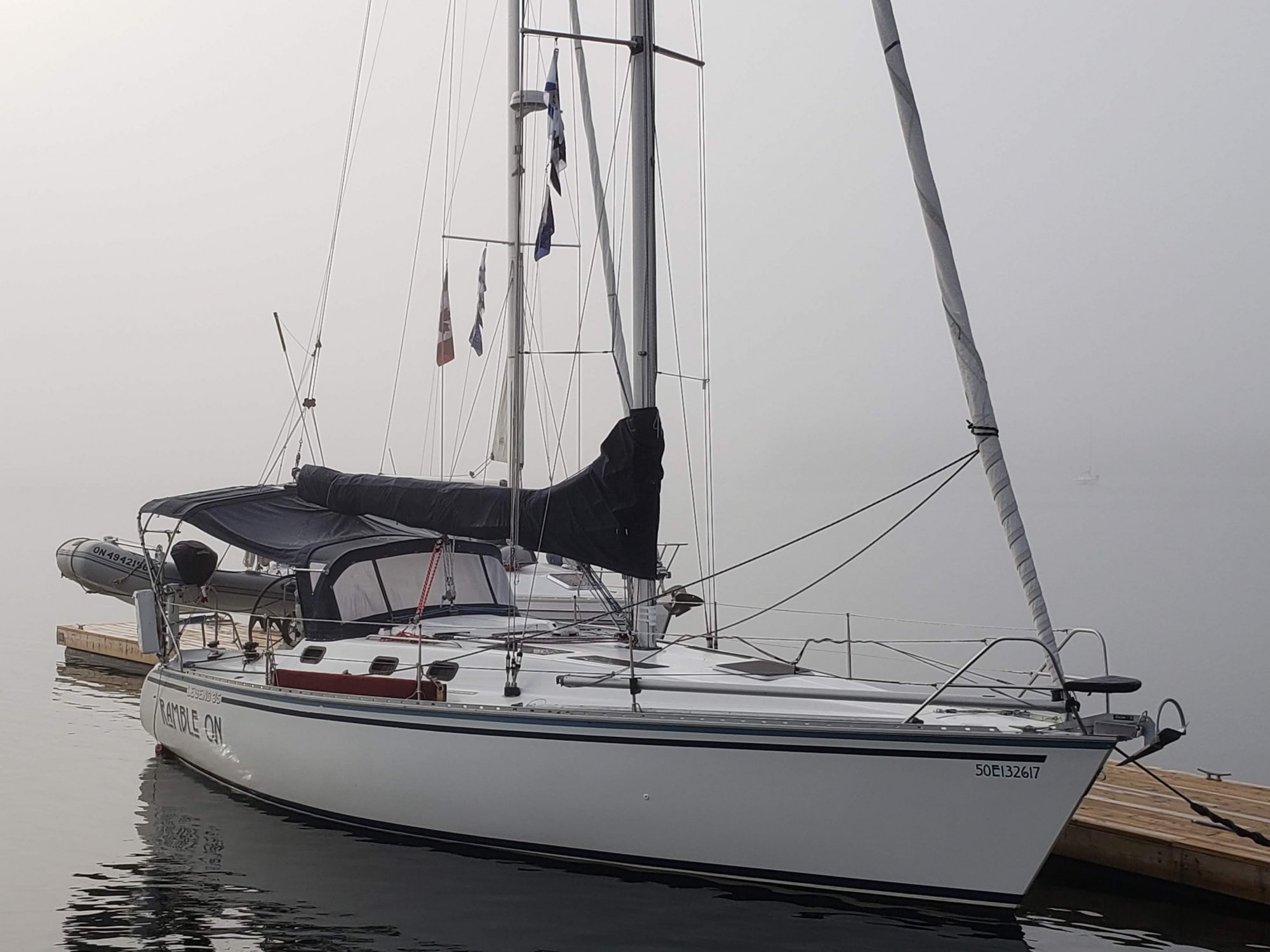

My boat is a Legend 35. I designed my bimini to give me comfortable headroom (I'm 6'2"), but it is a rather short (fore/aft) bimini and the boom is about 1.5" in front of (and below when close hauled) the leading edge of the bimini. The result is that the bimini is quite a bit taller than the dodger, and I can only use the awning when not sailing (because of boom interference). I could not bear to have to crouch or sit when at the wheel. The bimini probably gives me 4-6" of head clearance.
Edit: images attached20190815_081028.jpgDECR - 2019 - Day 5-Kahawake_2019-05-24_0007 (1).JPG

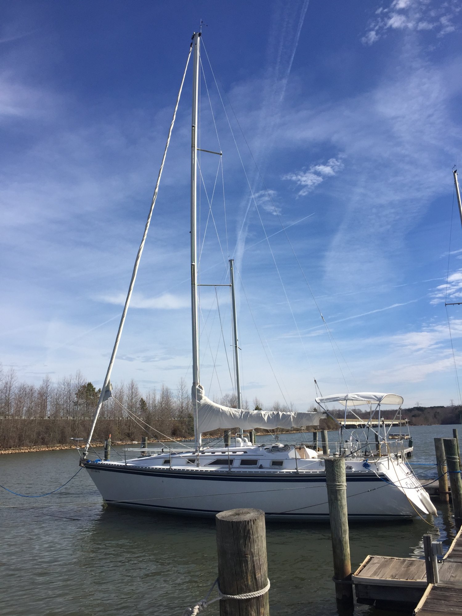

I have A Hunter 34 and found this one to work and is quite high. You do have to do a little sewing to either add velco or zippers to allow the top to get by the back stays
a pic of it on the boat.

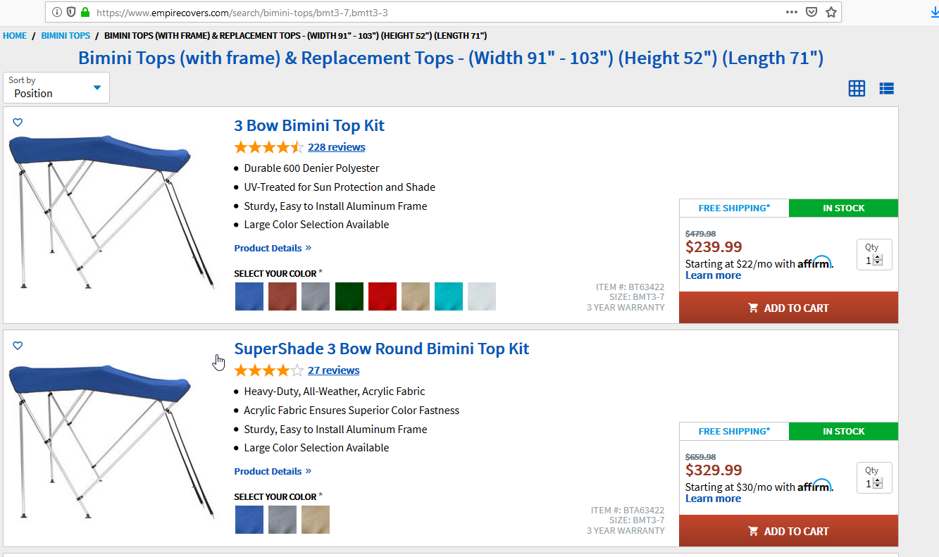

Sailor832, how did you attach yours to the rail? The pic you showed of the online ad says it is only 103" wide. My measurements to from rail to rail like it shows attached in your second pic is about 110". Did you just stretch the metal until it reached each side?
