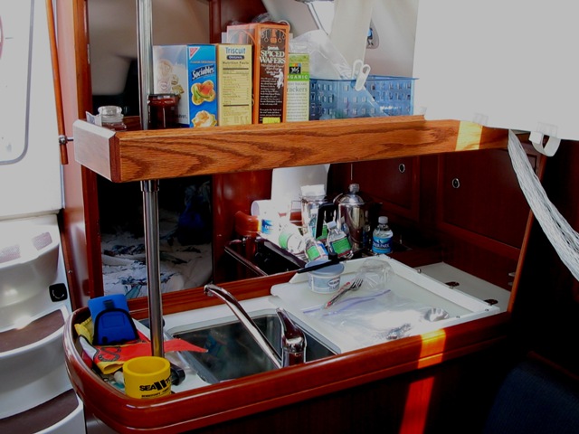

I put a vertical ss pole from the galley countertop to the strongest part of the overhead liner. Well secured, for sure. It does dual-duty to support a new shelf. It's the first place for a handhold once off the stairs.

I would feel a lot more secure with it through bolted and backed.
