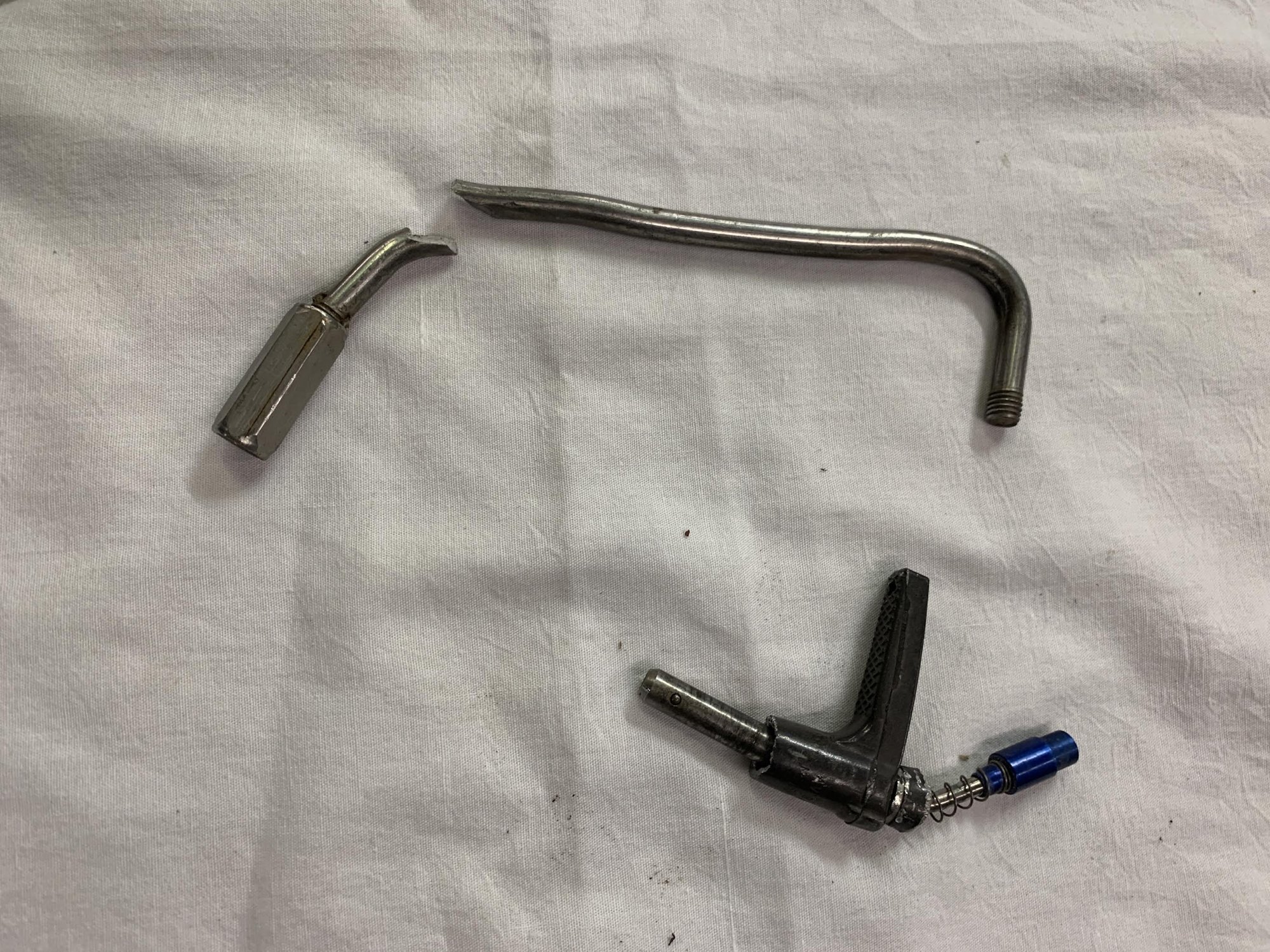

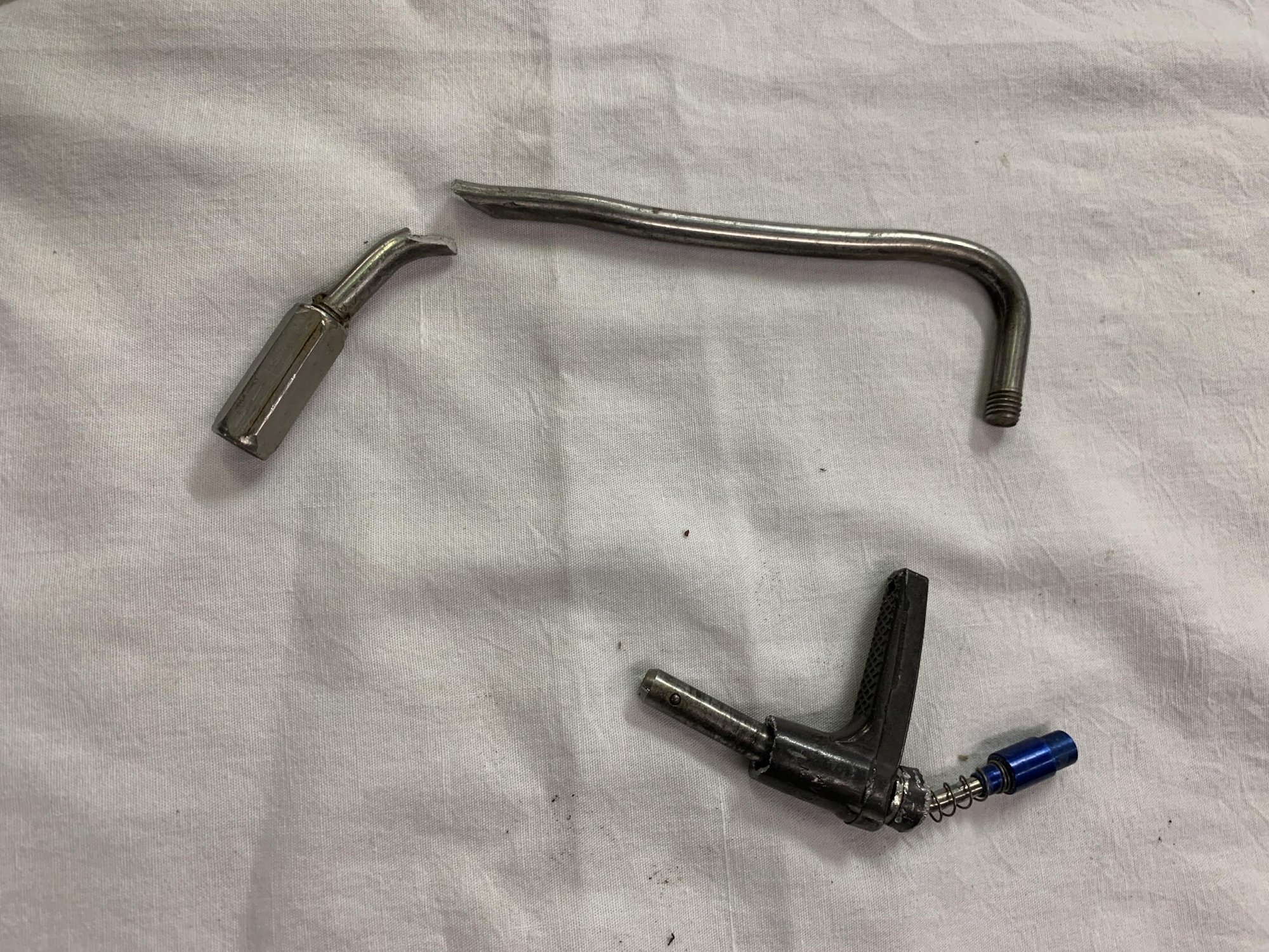

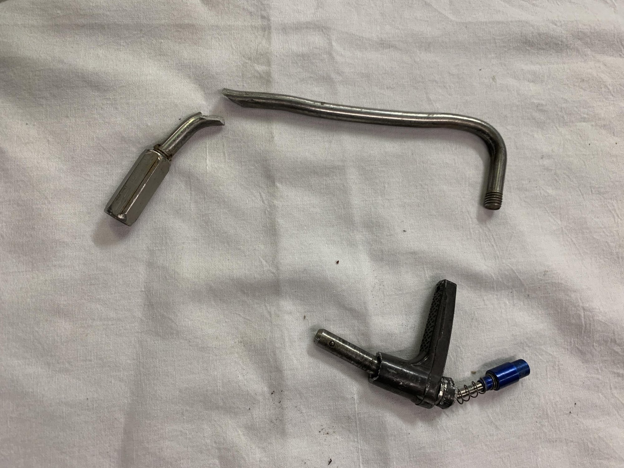

I've never understood the resistance to using hand swaged (nico press) cables. I built all new standing rigging for my M25 9 years ago and haven't died yet. As reported here a week or so ago I did have the unpleasant experience of taking the mast down wile on the trailer and snagging a tree limb :(, which did nothing but support my opinion on the strength of swages, as the only thing that broke was a SS quick link (note photo) on the forestay (ignore quick pin in same photo). I've also logged over 2000 hours airtime flying hang gliders in a previous life, which also use hand swaged side wires to support the wings. of course quality tools and proper use of them is vital no mater what you use, but I've trusted my life to them and will again. YMMV. :)
