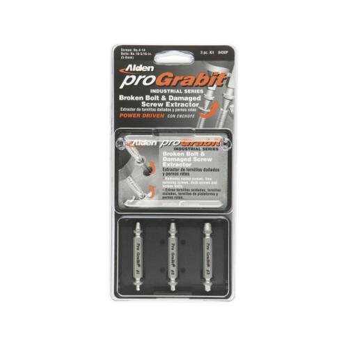

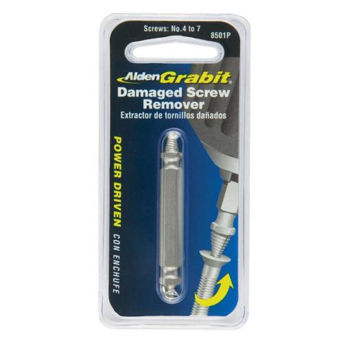

I am halfway through my interior refit. After the first 10 stripped screws, and much cursing in my paternal french, maternal spanish and adopted english, I drove to Lowes and purchased a Grabit kit. It contains 3 drill/removers bits for # 1, #2 and #3 phillips heads screws. So far I have removed over 300 screw. About half came out voluntarely, the other half had to be extracted. They ranged from tiny bronze # 4 that secure 1/4 inch quarter round to the largest stainless screws that hold the cushion fiddles and door frames. Out of all these screws, only one shaft broke and I had to drill it out. The best 20.00 dollars I ever spent. It has a drill head on one side and a reverse screw on the other side. First drill slowly the phillips head to form a small dimple. It cuts on reverse. Next, very important, make sure all the metal shavings are out of the hole otherwide the remover will not bite. After a thourough blow, swap ends on the tool and insert the remover head. Apply presure and reverse slowly. The satisfaction of seen the screw come out slowly is beyond words. I am the screw master now. They shake in their holes when they see me wip out my grabbit. They know the fight is over.:dance:
Good luck.
