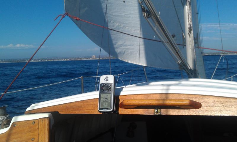

Garmin Gpsmap 76c, cs, or csx.
I use the 76csx with US coastal charts as primary, iPhone as backup, GPS-enabled PC tablet as planner/2nd backup.
The main things about the 76 are that it's small and unobtrusive, but mostly that it uses almost no power. 12ma. Cruisers should love that. And if you lose ship's power, it will still run on AA batts.
It has all the functions you need, plus a huge amount more including nmea out for AP etc.
Small yes, but if you mount it at the helm in front of your face, it's usable. Not amazing, but usable.
It is the end-all-beat-all backup if you have a std primary, for if you lose power, you still have a weatherproof marine chartplotter, running for hours on AA's, or forever if you carry a Costco pack of AA's :)
