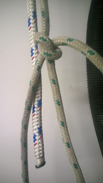

Using my spinnaker halyard I make a simple snare (slipknot) with a large loop. Make sure the knot tightens when hauled up and closes the loop when pulled down.
Bend another line to the lower end of the knot, as a downhaul (I use the other end of the halyard) and raise the snare so the loop is near the wayward halyard. You might have to pull it aft around the spreaders for the mail halyard.
Using the downhaul, maneuver the snare to capture the halyard.
You might need to rock the boat to swing the end into the snare.
When you wriggle the loop over the halyard PULL the downhaul to snare the halyard. Now just pull the wayward halyard back down. It can be a bit of a game, but rewarding to win.
