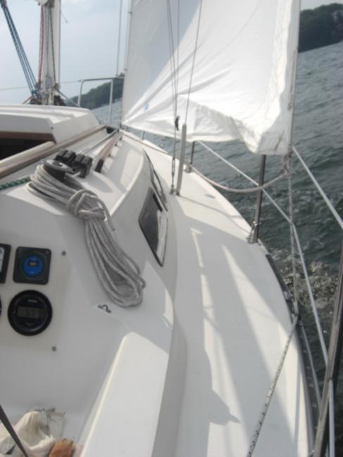

If I were you, I would probably not take the winch off the mast. It may be useful (say for a spinnaker halyard) there even if you do run the main halyard to the cockpit. I am sure you can use the cabin top winch that you use for the mainsheet. First, you will need a block at the base of your mast and there are various ways to do this. You can have a mast base plate that can accomodate several blocks, or you can mount blocks in the deck right at the base of the mast, or you can mount a halyard block on the mast right at the base as you can see in my picture. Mine came from Rig-Rite and it is a Kenyon block (very expensive). Then you will need a deck organizer, if you don't already have one. They also come in a variety of configurations. Mine has four sheaves, with 2 pair stacked. You can find these from Schaefer or other hardware suppliers. I have 2 pair on each side so I can have a total of 8 lines leading to the cockpit from the base of my mast.
The rope clutches are very useful and I love the Spinlock XAS that I bought. I have 2 pairs on each side. After you hoist the mainsail, you can find a place to hang the coiled halyard and you don't have to use the winch drum as I do when I'm being lazy.
