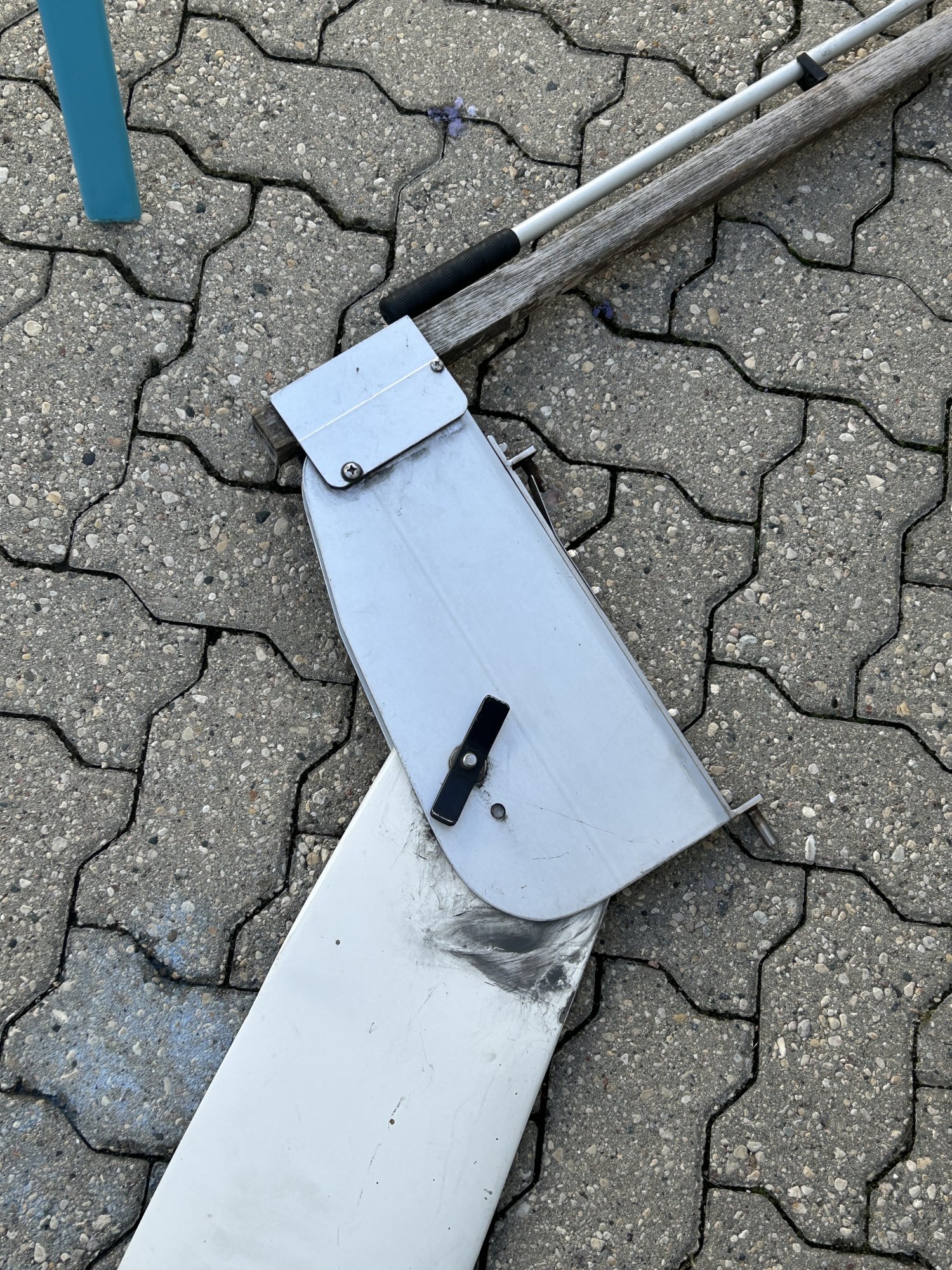

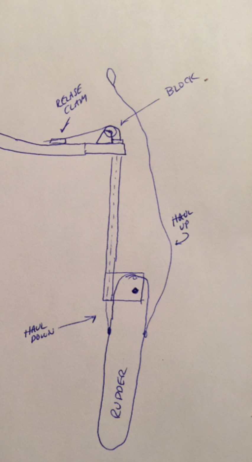

Putting the rudder down all the way is a two hand operation. I to push the rudder down and 1 to tighten the wing nut. Has anyone done a mod to install a couple of line to lift and deploy this rudder on a Catalina 16.5. The hand drawing I got off the site and picture of the rudder attached. Thanks.

Easy enough to do the same as the drawing. Clam cleat, small block and rope. I had a 16ft dinghy that had that setup from factory, ages ago. Worked well enough.
