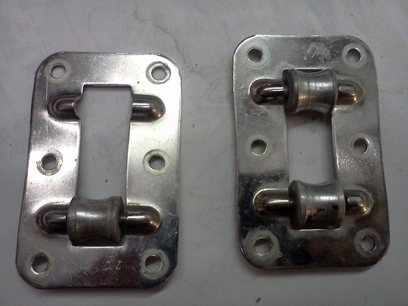

I have two exit plates that I have replaced while re building my mast. They look original and have 2 rollers in each one. One is complete and one has only one roller. I could not find replacement roller so I replaced them.
There might be someone that has the same plates and needs a roller so they are yours for the asking. Hate to throw them away.

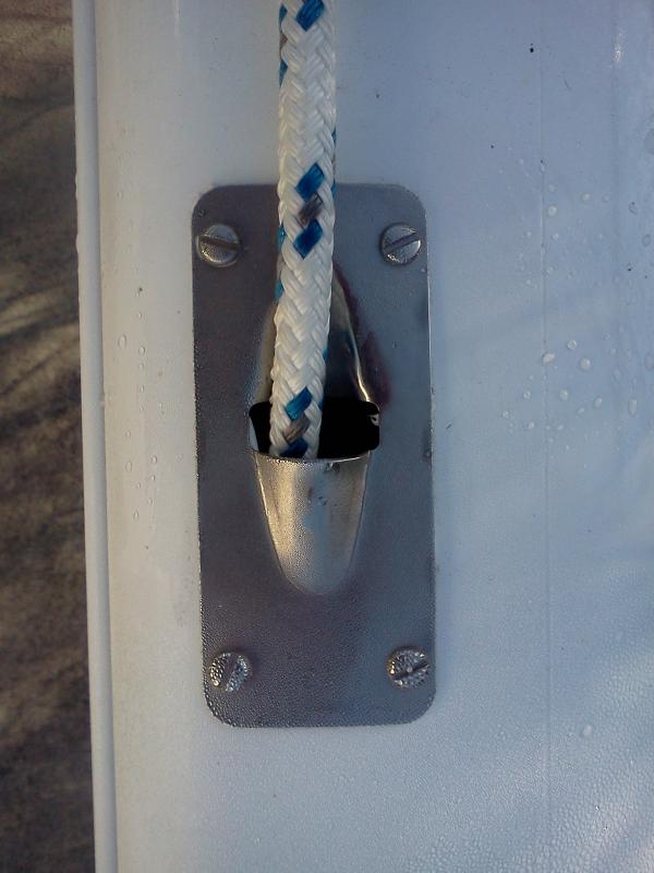

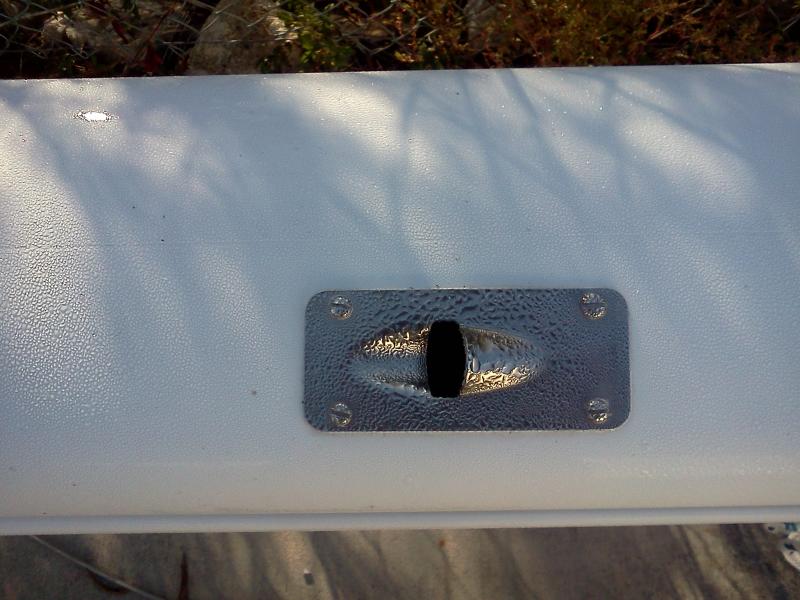

I did some research and the SEADOG exit plate was large enough to cover all 6 old screw holes. Very reasonably priced and right here in the Sailboat Owners Shop website. My mast is fairly large so the flat plates worked the best. I screwed one side first and gave the plate a slight curve (with a dead blow hammer) to adapt to the curvature of the mast. Used plenty of bedding to keep the new plate from eating my brand new paint job.
