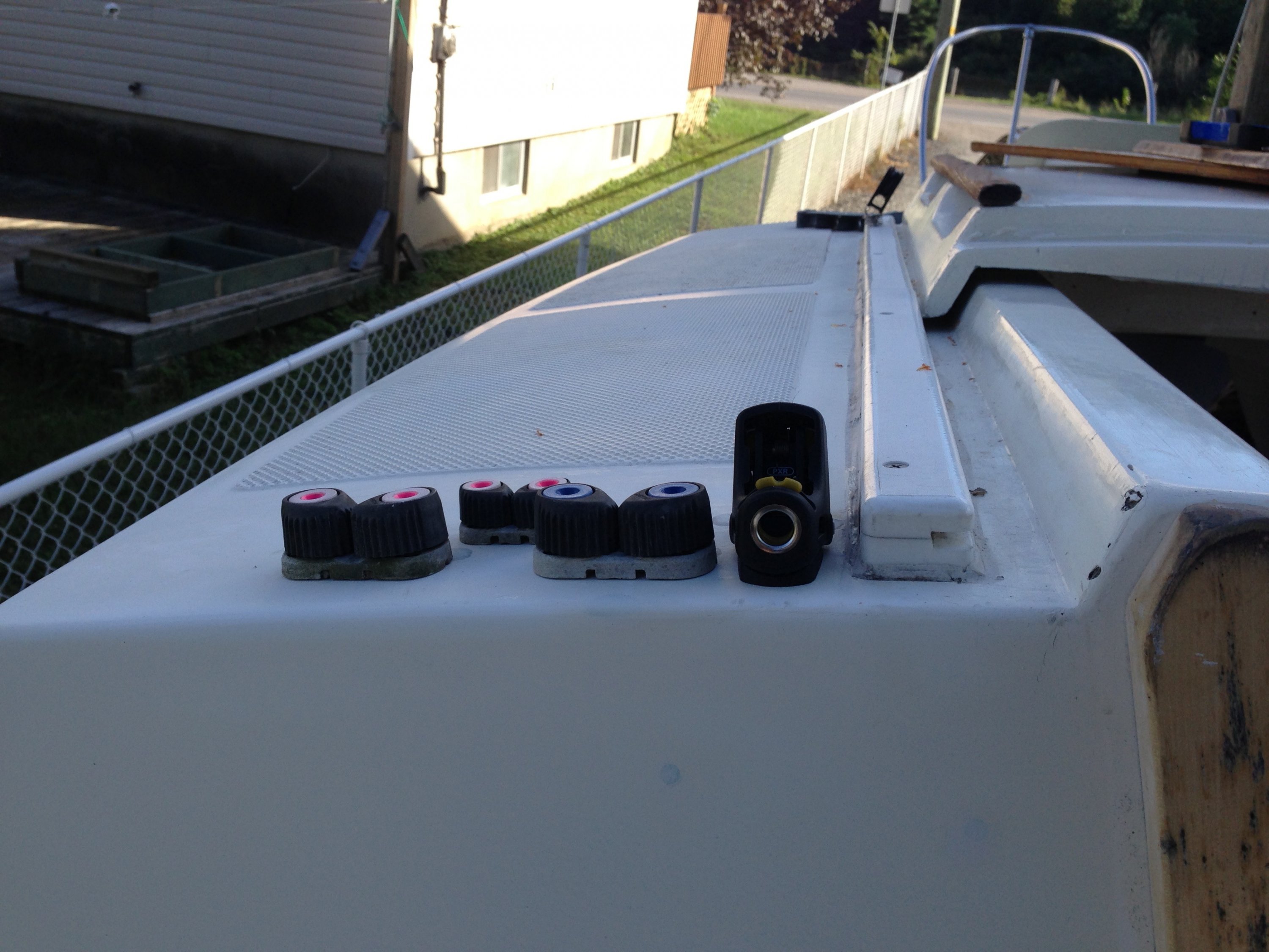

it would help to see what your actual setup is like
on my dolphin 23 the cam cleats and the spin lock units are on the side of the companionway on top of the cabin roof

I installed the spinlock axs 2 on my boat this spring, I mounted them next to the clam cleats.
I drilled 4 new holes thru the cabin roof, I put some sealant underneath the spinlock, and it will tell you, where not to put sealant. I made an aluminum plate same size as the clutch, with 4 holes in it, I mounted that on the inside of the cabin roof for extra strength. And I think I used 1 1/2 inch length stainless bolts, I don't remember the size.
It was actually pretty easy, and it works great, I'm happy I did it.

@mmhammer, @Karyon & Scotty147:
I'm curious, what years are your H23.5s? My 1995 has only one clam cleat (also called a V-cleat and has no moving parts), which is for the centerboard uphaul. (fred1diver posted a photo of "cam" cleats.) The halyards go from the mast, through a deck organizer to a double clutch that's forward of the winch. The only other hardware is the winches and the horn cleats (which I replaced years ago with Spinlock Powercleats).
I wonder if my double rope clutch is not stock? I bought the boat in 2002 when it was 7 years old.
My jib halyard is not used due to my furler, so I routed the boom vang through the 2nd clutch no longer used by the halyard.

I should have mentioned that the double clutch that came with my boat eventually wore out and wouldn't grip any longer. I replaced it with a new spinlock xas /2, and found only four holes, two sets of fore-and-aft holes, and nothing else. In other words, if somebody replaced the factory clam cleats they (and I) were able to use the same tapped holes in the factory installed backing plate.

There is an aluminum plate encapsulated in the fiberglass. I am not sure if the area in question is raised or simply flat with no non skid appearance. A photo to refresh my memory would help. You can place a double rope clutch if you stay within the area of the two cam cleats and possibly use existing holes. If you want to see if you are in the area of the aluminum plate which is about 1/4 inch thick, drill a small pilot hole to see if you get aluminum shavings coming out but do this one at a time. If filliing holes simply use 5200 if being covered up or use a good two part epoxy.
As for simply putting a plate on the inside of the ceiling in cabin, no dice unless you fill the voids between ceiling liner and the deck; otherwise, you will be pulling the liner upward and that is not good unless you can fill the voids.
Fred1diver, suggest attaching pad eyes over the clams to keep the lines within the cam cleat area to avoid having to get up and putting them back in.
