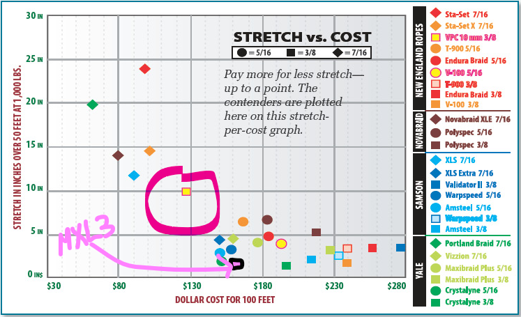

Catalina 30. My main halyard is actually just fine. I don't know what it is, but it is a good stiff non-stretchy rope that has life left in it. One of my extra halyards though is gone beyond it's days, and has lost it's cover and needs replacing. So, I was going to move the main halyard line to the less-used extra position, and buy a new main halyard. (maybe that's not what I should do? Please let me know)
I want something that will last a long time and has the right properties, but I don't need to spend $5/ft for a racing halyard. I don't race.
I was wondering what you all thought of the new Samson MLX3? It's priced pretty well, $1.45/ft at defender for 10mm(13/32)

We have been using NE Ropes VPC for several years. It has a low stretch high tech core and a polyester cover. At a similar price as the MLX3.
Likes: Parsons
Jun 2, 2014
603
Catalina 30 mkII - 1987 Alamitos Bay Marina, LB, CA
Just pointing out that Practical Sailor's chart doesn't poise VPC as a good low-stretch rope? I put the MLX3 data point on myself to show where it would sit:
13,473
It's your boat and your money. Buy the line you want. When I replaced my halyards it was the best value for low stretch line on the market.
