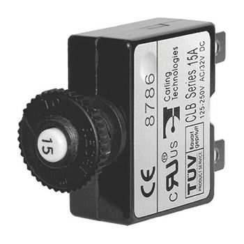

I believe this is where you will find a push button reset for the CO detectors rather then a switch/breaker. It may look like this (maybe different amperage). Given that the detectors are safety equipment, I would be surprised if the fans are also connected to this breaker. Possibly the fans are an add on after manufacturing. Good luck.

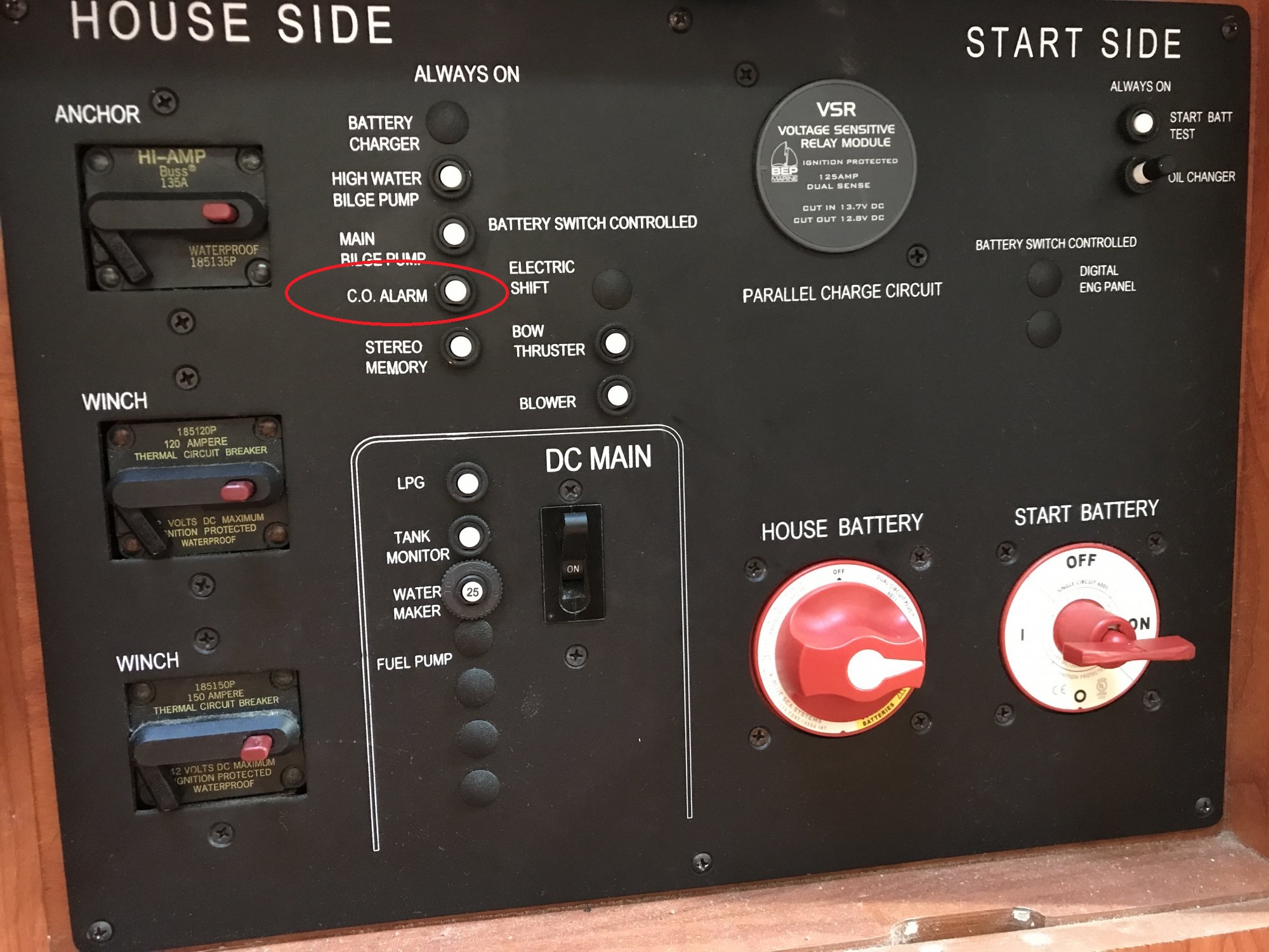

Here is the panel with the CO circuit. The main cabin CO monitor is still on and the white button dose not appear to be tripped and there is continuity through the switch. So I need to find a separate circuit feeding the front cabin.
This is kind of off topic but I see from this picture that the anchor and two winch breakers are tripped. Is that intentional?

WOW, there it is in all of it's curious logic !
I don't see a Hunter label on this "always on" panel. Trying to understand if this is a remake of an original Hunter 'always on" panel and hence may make the wiring a little strange.
This will sound a little odd but "do you have voltage on the outlet side of each breaker?" The refinery electricians I worked around would always consider this to be the "absolute" proof of a breaker performance rather than the breaker's continuity which everyone else would consider to be proof enough. Not for them.
Also, I presume the BLOWER breaker/indicator is for engine cooling ventilation and not cabin fans. Correct ?
Hopefully this only indicates a discontinuity with the wiring leading to the front cabin CO monitor. There will not be a fuse in the CO wiring as the wiring is protected by the panel mounted breaker/indicator only.
Please supply answers what you can and we'll go from there.
