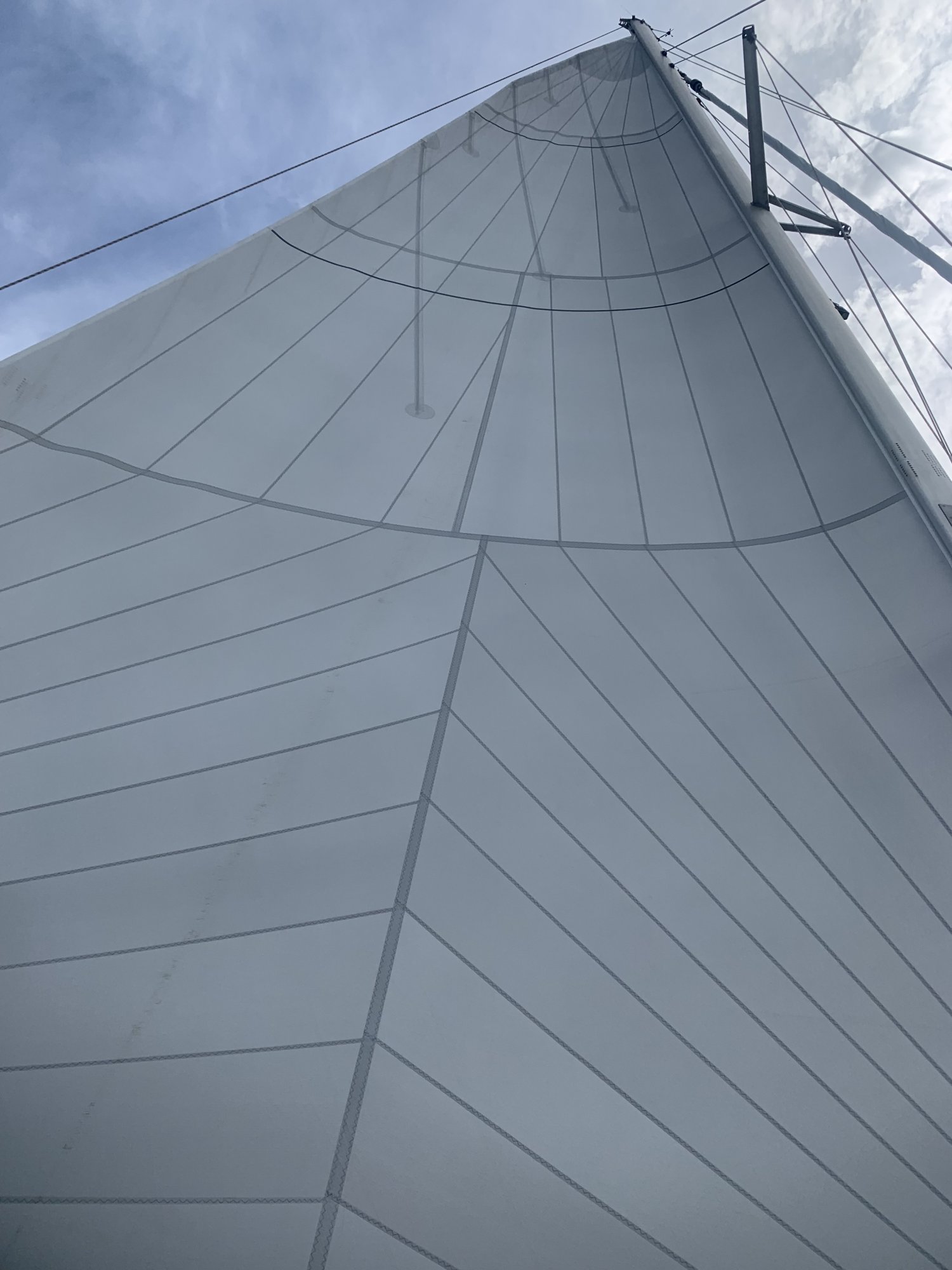

We had a new Dimension/Polyant DCX cruising Mylar in mast furling mainsail made last year form Impulsion Sails in Tunisia. It has been good with the batten arrangement in the photo. Our previous mainsail was similar material and lasted 10 years and 30k miles sailing from west coast Mexico to the Med. The Genoa is made from the same material. Although we are on a 46 foot cruising catamaran, our sail loads are similar to your boat or slightly higher. We have the Selden Mast.
