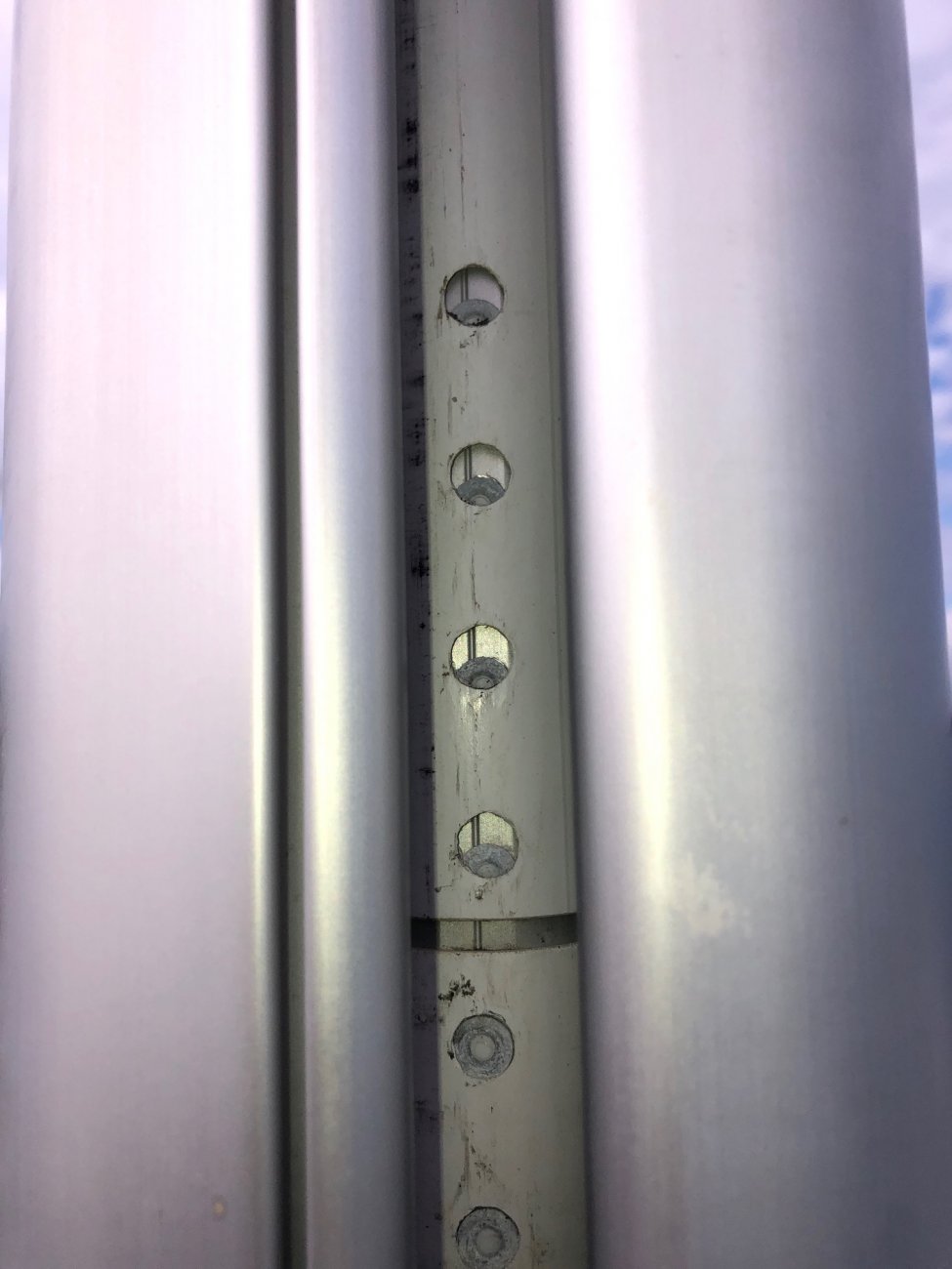

Hello, does anyone know what model is the Selden inmast furling for the H49 2009? RA MK III, RB MKIII or RC MK III?
I am having problems with it, I when up the mast and found out the Luff extrusion assembly is slidding from the rivets (see photo attached).
Also it is very dificult to raise the Halyard swivel, even without the sail attached.
Is it possible that the extrusions lost its form?
Any help will be much appreciated.
Miguel

Not an uncommon problem. Unfortunately, the only reliable way to fix it is not what you want to hear so I won’t...

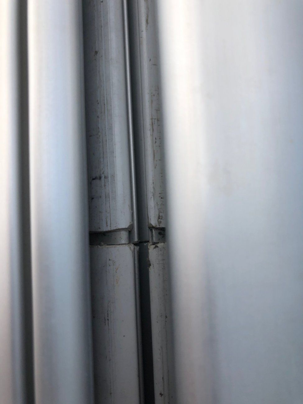

Hi Miguel, just like I feared that the foils/extrusion fasteners may have come undone and in my case I believe that the foil is twisted (I used the electric winch to try to pull the sail out…out - do not attempt at home ). I since have learned to keep the system lubbed and if the sail doe not want to pull out I step on the boom and push the bulging sail back inside the mast with a wooden wedge. I also try to wind the sail in so it does not bulge out.
The mast has a serial number (see Pictures) in the port side just above the deck. Call Selden and they will have a parts list of all the items installed at the Selden factory. Your pictures confirmed that the foil is not a single extrusion.
How many extrusion did you find?
Miguel
I believe this is a major rig service, and the foil has to come out.
This means the mast comes off, the masthead is removed, and the extrusion is pulled
I would have this done professionally.

Thanks for all your help. I will have to go up again and count them cause I stopped at the first extrusion joint.
