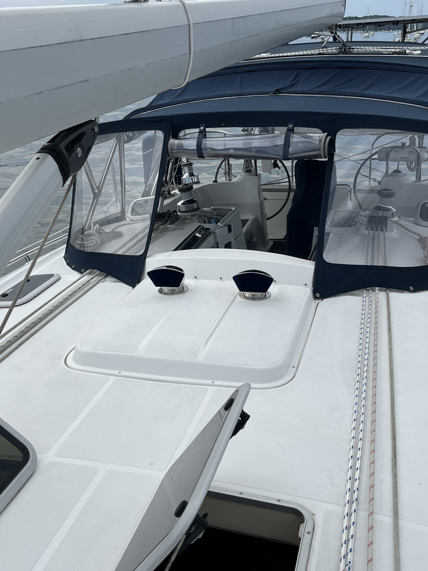

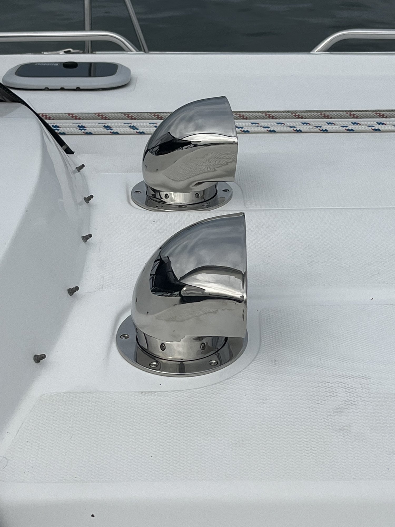

Replacing the old dingy ones was on the top of my wife’s list of improvements. I deferred for two seasons but then found some nice stainless replacements. The inside can be custom powder coated. I went with dark blue to match trim. Doesn’t show well in the pics. The source I used was Buchan Marine Low Profile Cowl Vent with Deck Plate

Those look absolutely gorgeous! I'm just not sure I'm sold (cause the SS ones you got aren't cheap) if they are purely cosmetic and non-functional. I will absolutely keep the link though, because if I can prove to the boss that they actually will move air down below, it will be a much easier sell to her. If they're cosmetic? I may go back to dropping in the cover plates and calling it a day.
Thanks!
Those look awesome. We’re they a direct bolt on? What size did you go with?

I aslo replaced my tired PVC cowls with large stainless steel ones from Shop | Buchan Marine. Same screw pattern fit without new holes. Very good value for money.
Thanks, 4 inch fit perfectly in the existing hole. Just needed to drill slightly different hole pattern.
