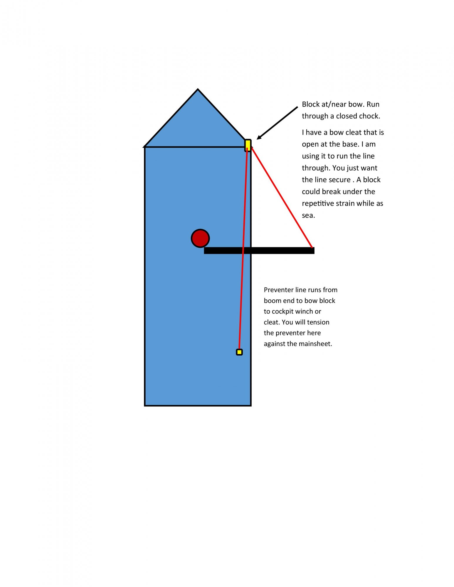

I hear you... This image is rough but it nails the important parts.
The issue with many who are considering a preventer is they are imagining moderate conditions and preventing the boom from sweeping across the cockpit and hitting someone. Sure that is a function of the preventer. But the preventer is that and more.
For one it helps to prevent the boom being damaged in a down wind scenario with the boom being dipped into and ocean wave.
Rigging a mid boom preventer creates the opportunity for the boom to be damaged - "folded in half" in such an event.
You may never sail in conditions requiring a proper preventer. It is good to know how to rig one.

23,845
Daze, Cruising with a preventer at mid-boom can cause the boom to fail at the point where you attach the preventer. All it takes is for the boom end to dip into a wave, and the mid-boom stress point will fold. Not worth the risk. Better to attach the preventer at the end of the boom.
