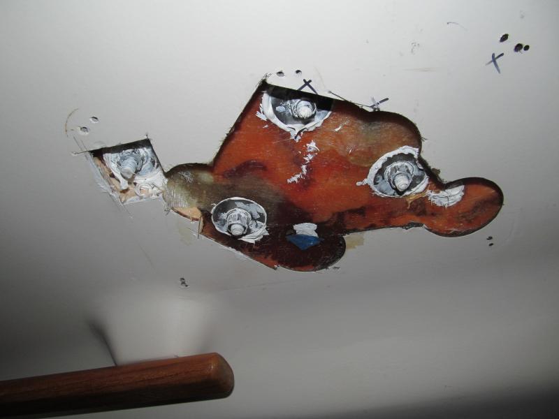

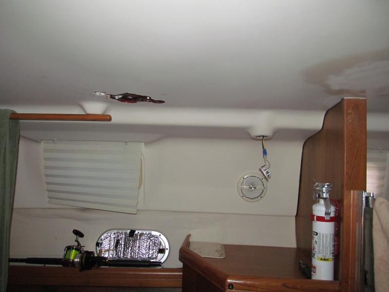

Looking for anyone who may have experienced similar leaks in aft cabin of H456 and/or recommendations or solutions.
PROBLEM: Water leaking at (2) places, port side aft cabin & unable to pinpoint location. Leaks during moderate rain...unable to duplicate with high pressure hose.
--Leak 1: SS arch mount bolts access panel (not the bolts; this was fixed).
See picture 2, H2O appears to travel from center of boat to port & drips out access panel, inboard side only marked by "x" in photo
--Leak 2: Port side cabin light fixture. H2O is traveling from aft deck down wire bundle & to lowest point in ceiling, which is out the light fixture. Fwd of the fixture is dry.
