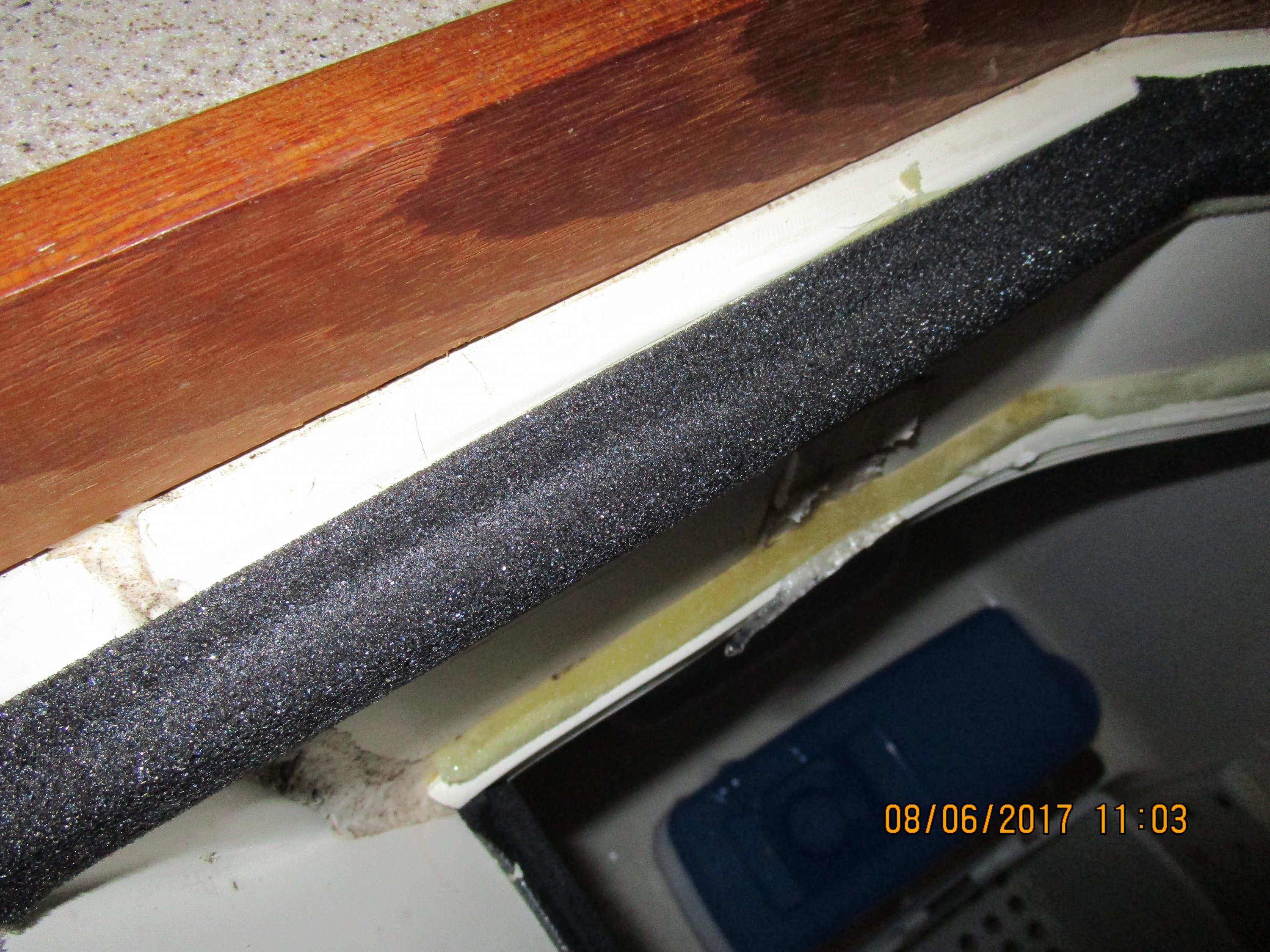

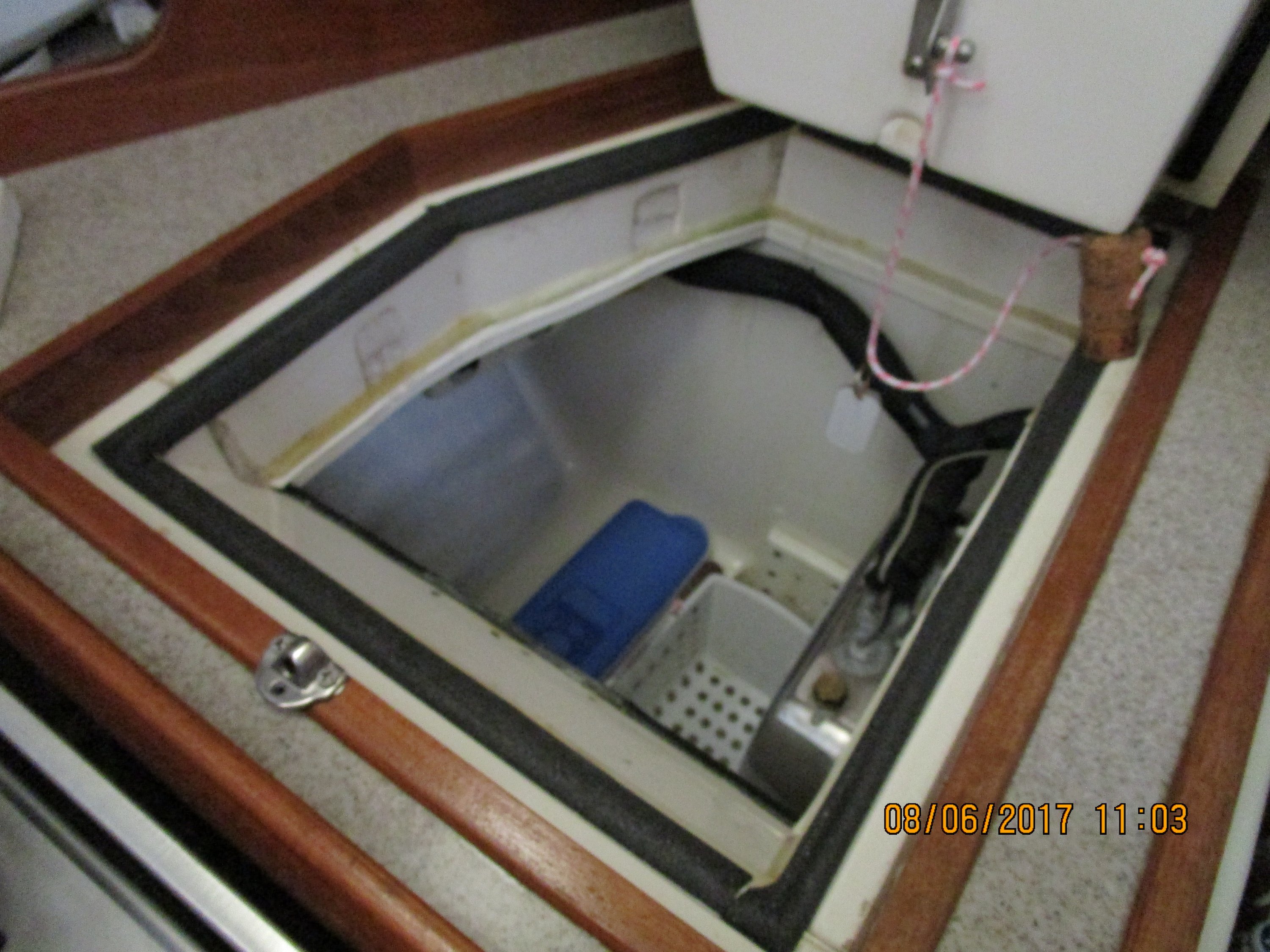

SUCCESS!! I applied a soft foam strip- 1" wide by 3/16" thick onto the edge where the factory seal closes. As the width is 1" the overhang folds down into the cabinet and forms a secondary seal for the tapered sides of the lid- I will post some pics later, but after years of fiddling about- its great to have a good effective seal!

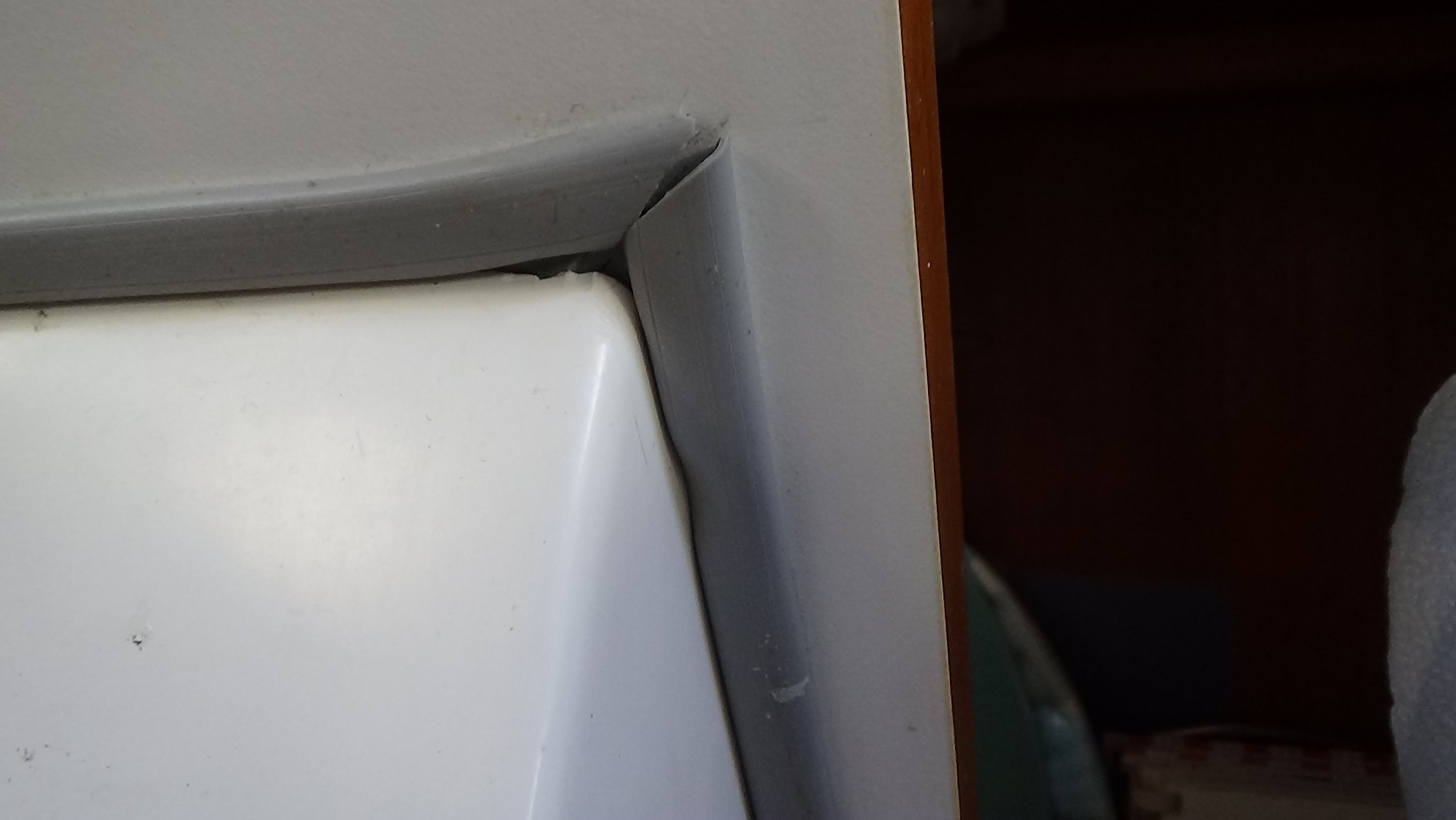

Photo below shows the original grey stuff installed by Hunter.

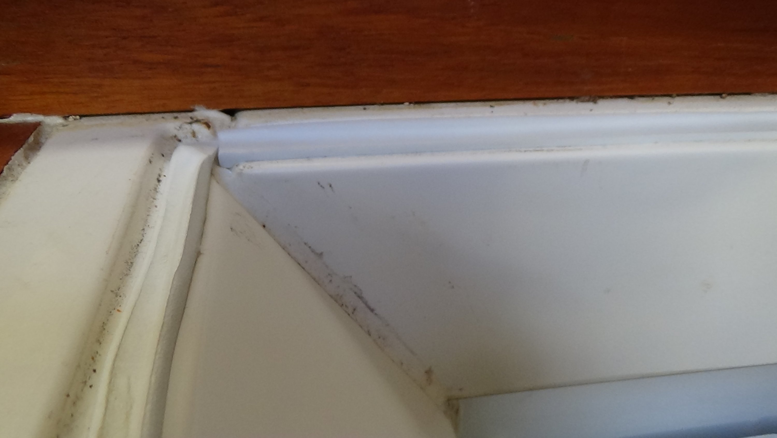

A closeup of the grey stuff.

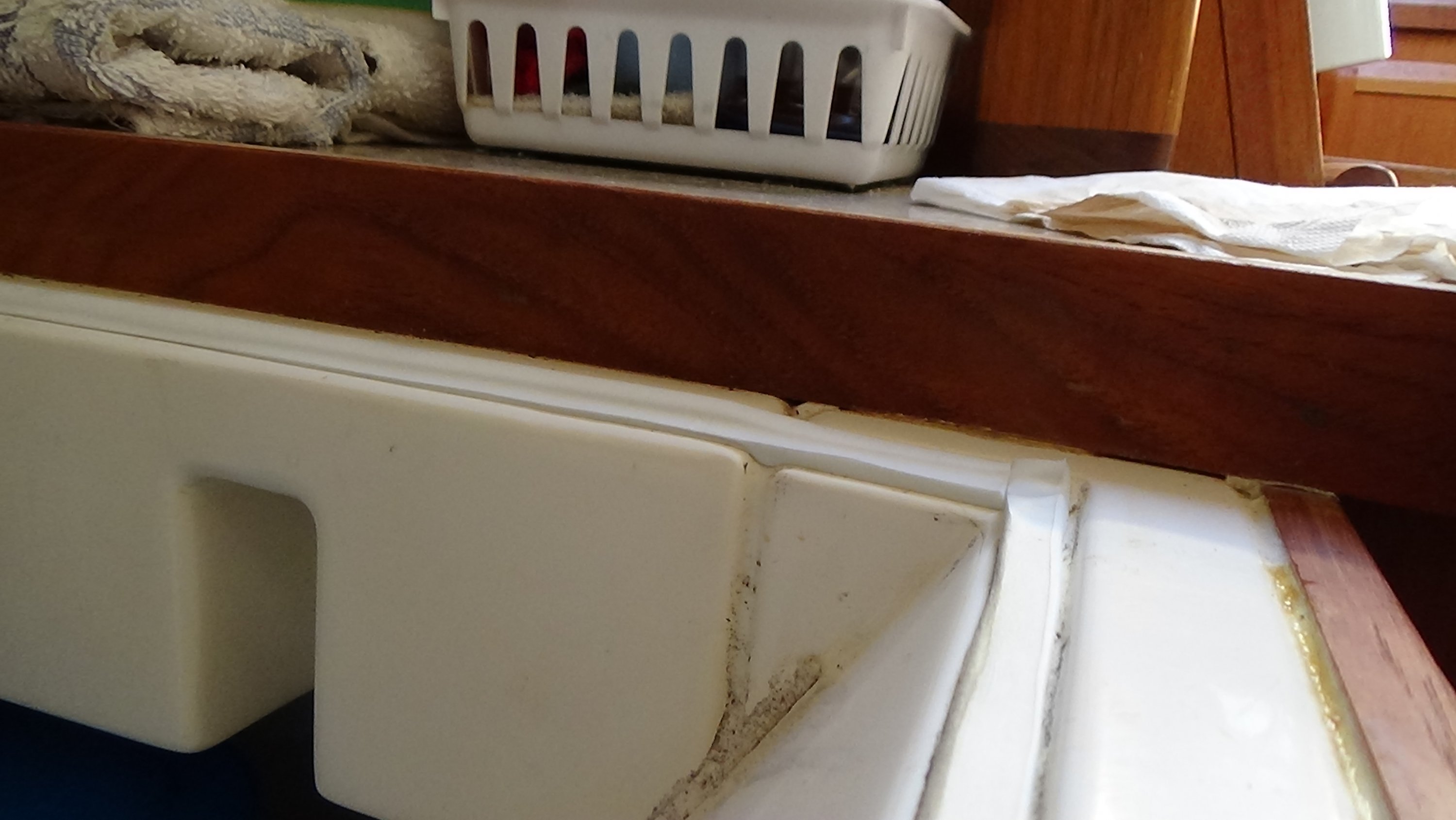

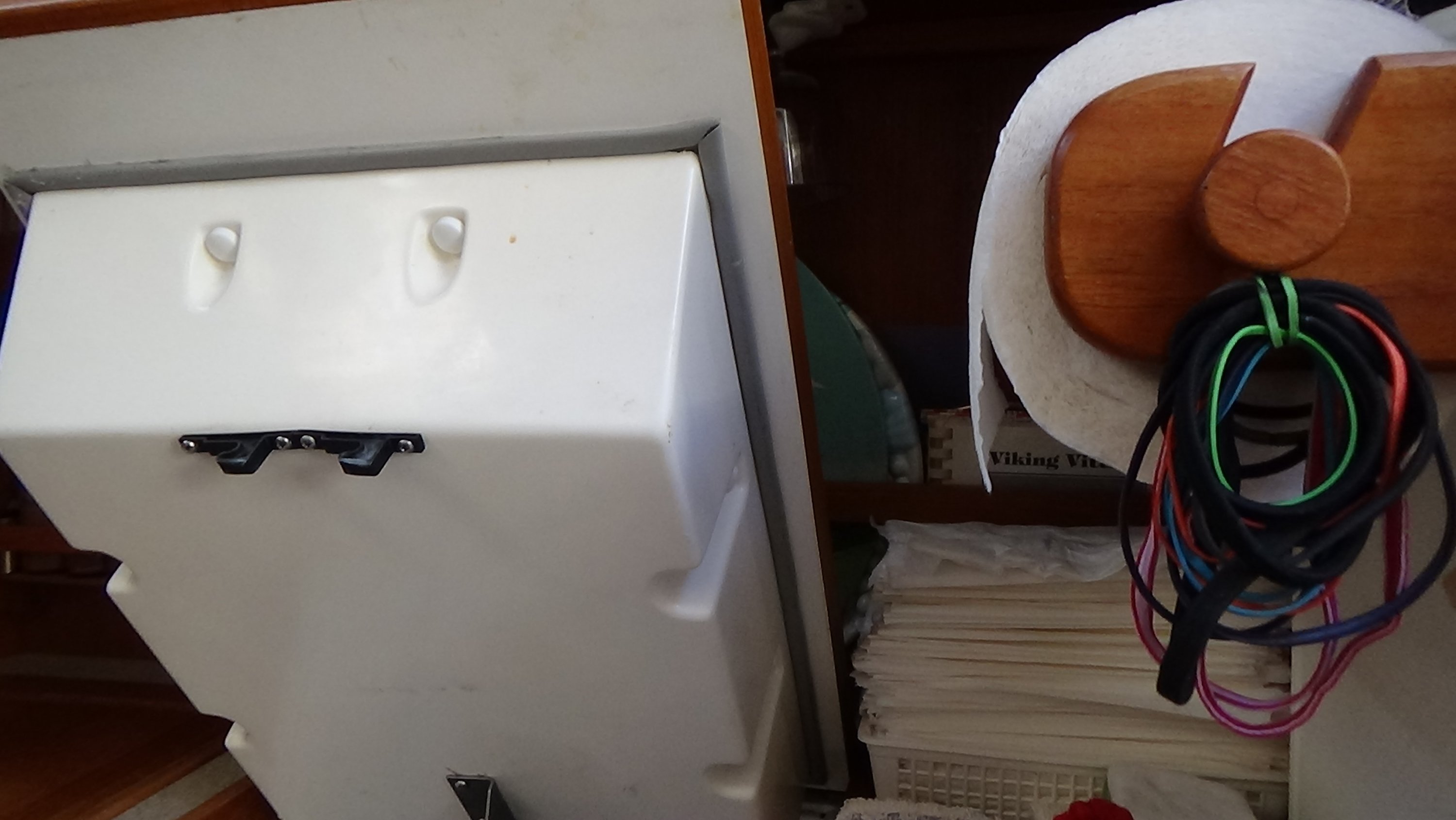

Big box store quarter inch thick by half inch wide self adhesive foam weather stripping installed on reefer sill.
The grey stuff closes down on the weather stripping, which eliminates the small gaps that were evident using a dollar bill test. Did this several years ago and it has greatly reduced the frost buildup and cooling cycles.

Here are 2 pics of my over sized open cell foam seal that folds down into the cabinet

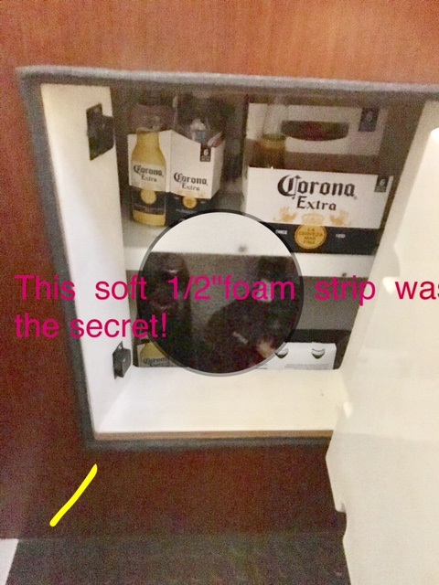

fridge front door seal.jpg sorry about my delay- its winter here! I have finally found and fixed my air leak into my freezer- it was the front fridge door- I used the exact same soft open cell foam as recommended by Terry Cox for the original factory seal to seal on ( stuck the foam strip onto the timber where the factory seal contacts) did this about 6 weeks ago and I have virtually no frost build up on my Eutectic plates and I have minus 12C in my freezer- its taken 10 years, but I WON!
Dec 25, 2000
5,946
Hi Eian, glad to hear the good news. A simple solution that worked. But those Corona Extras sure had my mouth drooling for a cold one. Got to be beer-30 someplace. :clap:
