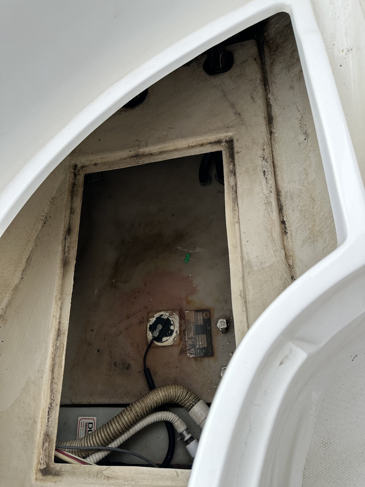

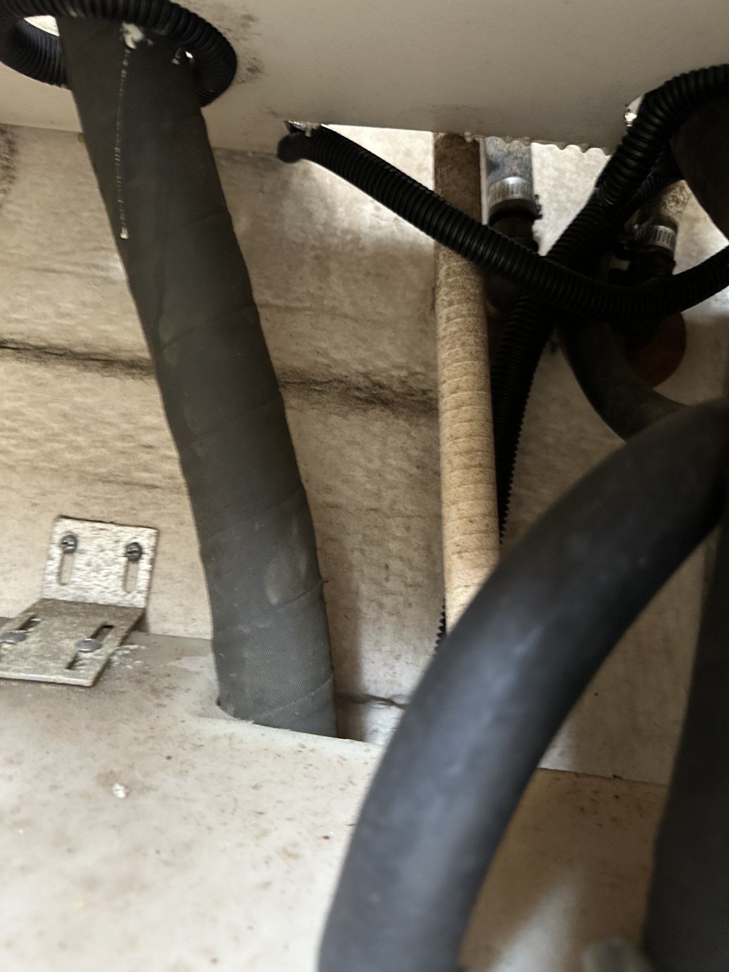

Trying to clear a clogged waste tank vent on my 410. It's extremely difficult to reach. I can see it under the floorboard of the port aft lazarette but accessing it to unscrew the hose clamp is an impossibility. I got stuck in a rather hilarious manner with my legs flailing in the air. It might be possible to access it through the rear bulkhead in the aft cabin but I'd have to do some unpleasant disassembly of the woodwork I think. Anyone else know of a way to access this vent hose? I've tried to spray it out with a hose on the outside but it has a 90 degree chrome cover on the outside of the hull.

I was able to clear the clog from the tank end. Gross!!! I’m still curious if anyone’s found a way to access the external mount on the inside of the hull

I changed the vent hose out on my 410, yes, I got stuck in that lazzeret once also but it is possible. Always have another person nearby in case.
