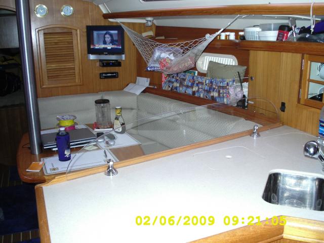

Well here is the one off a newer H-38 that I ordered from Hunter for on my 2007 Hunter-36,not cheap but really looks nice like as if it came from the factory.
I installed it my self and did not need to modify it at all for my H-36 and saw it on a new 2007 H-38 at the dealer,don't know why Hunter only puts them on H-38 and up and I like the nice window shades on the hatches also that they use on the bigger Hunters which I will be adding soon.

As Steve points out, you can purchase a galley splash guard from Hunter Marine. Call Ronnie Barnes at 800-771-5556 x 4 or email him at retailparts@huntermarine.com. These are the two options he quoted me for my 2004 386:
1. 55" long 6" high with a raised center, clear Plexiglas #1028981- $132.32. Brackets attach to the corian top are sold separately
2. 32" long straight across the top, clear Plexiglas #1022595 - $84.82. Brackets attach to the corian top are sold separately.

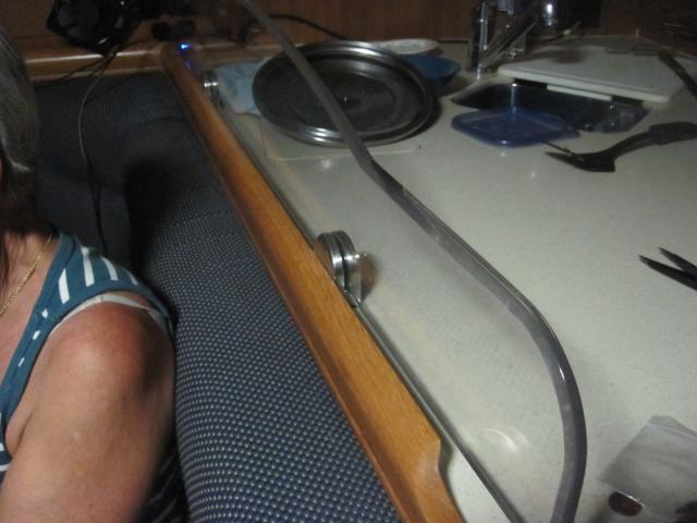

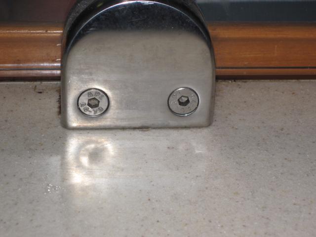

I added a splashguard to my 04 h36 in 2006. The brackets came from Ace Hardware, a glass shelf originally for the bathroom and then purchased the 1/4" Lexan piece from a plastics company locally. Total cost was about $50.

The brackets similar to the one's from Hunter are used by Glazing Contractors on glass railing installations etc. Check with your local glass guy. I did find them on the internet once, but can't find the links again.

The glass shelf was placed in the dumpster and just the brackets used. Plastic came from TAP Plastics. As I remember the shelf was about $20.
