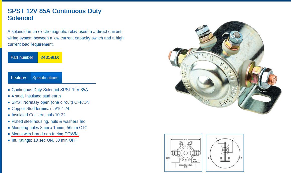

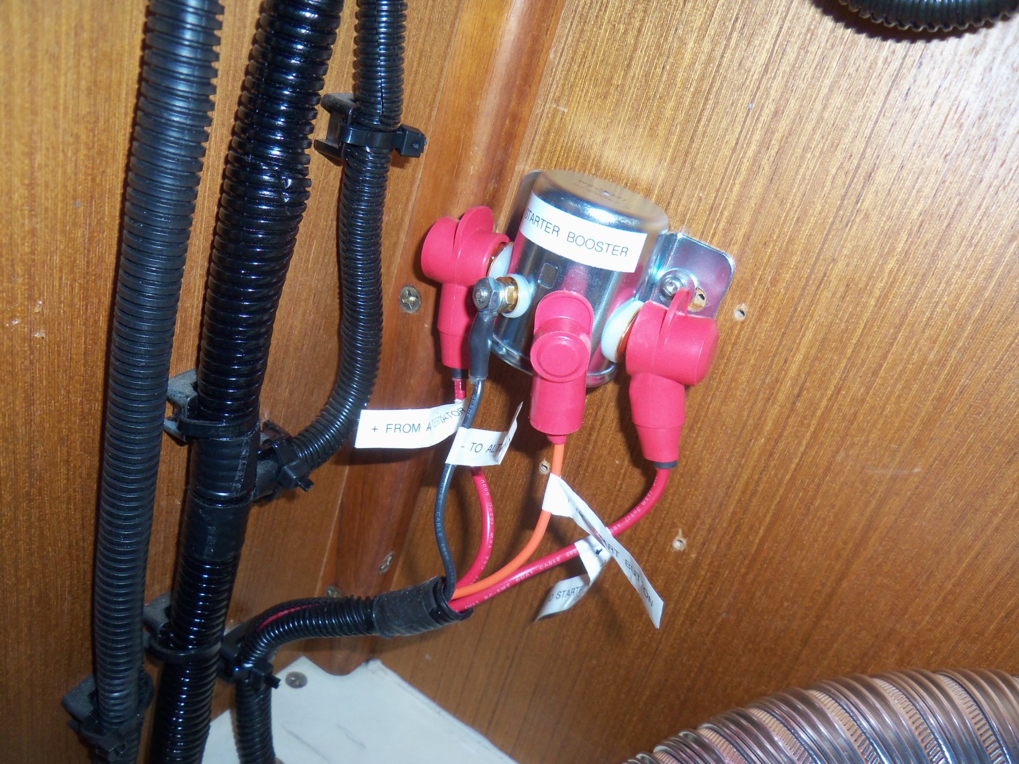

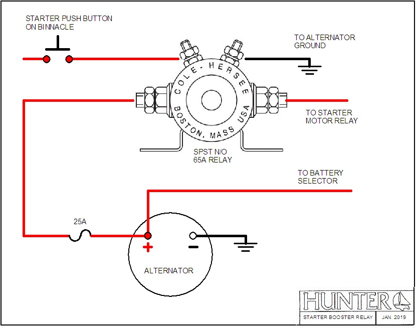

Did that only once without a lot of improvement. Hidden plugs and worse. The big problem is that the engine mounted starter solenoid switch pulls about 17A. That's a lot of amperage to push with only 12V. The Cole Hersey relay only pulls about 0.1A.
I finally gave up and installed this:
Never had another problem.
Ignore the connection points on the wiring diagram as this is the as-built drawing showing the actual connectinos for wiring convenience.
