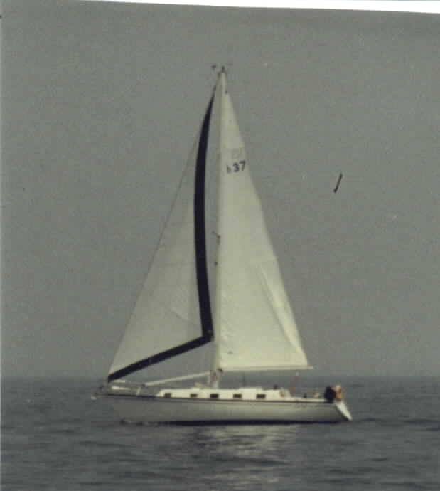

Some months ago we debated the dimensions of a '135' yankee. I had suggested that a 135% headsail on a cutter was in relation to the mid-stay. I was overruled, a '135' uses the same formula regardless of whether it is a cutter or a sloop. But then JCII wrote and supported the idea that the cutter formula is different. So at this writing I do not have a clue! :) At any rate I have attached a picture taken early this year before I even had the staysail on the boat. So you can see that my new '135'(from Lee Sails) is larger than the standard yankee. Enough so that I only use the staysail if someone is catching me. Almost never happens.

hey ed...don't you find taching the bigger sail thru the slot to be a bitch.. I tried the 130 that i have and after one day tacking around on the river where i sail, it went back in the bag and i'm ready to SELL it. Every time it came to tack i had to run up to the bow and feed it thru the slow between the inner stay. i am sure that my local sailmaker will love me as i will most likely be there once a year to have the seams restitched. maybe if i spent more time offshore it would be better but where i sail we tack often...FWIW

Maybe I don't know what "easy" tacking feels like. But I don't think this sail is any worse than the original yankee. In real light winds I sometimes wish I had splices instead of knots on the sheets. It might hang up for a few seconds. You would think it would be bad when you see that more than half the sail is behind the mid-stay but it really isn't. I never go forward to assist it. I should point out that I don't tack very much, there's a lot of open water where I sail on Lake Erie.

I like Ed's set-up. So long as sails can be changed on the furler foil, it looks like he has the best of both worlds flying that big 150 off the outer jibstay when conditions warrant. Yes, it requires some work in tacking but you can't go by what I say because I grew up sailing a cutter-rigged C-44 on the River and tacking was a way of life. And we had NO roller-furling so in summer it was always a walk-around job. The yankee was cut high on that boat and this usually entailed carrying it round by the sheetline itself. But once around it was no bother. In response for what Yehudi said about the jib measurements, the J is always 'assumed' to be from the front face of the mast to the tack fitting of the outermost jibstay. On a cutter this is implied to be the outer jib and you may see the inner one given as J2 or something. This dimension is irrespective of what your sail combinations are and really serves to represent the foot of the largest sail that can be flown on the stay in the foretriangle (i.e., there is no proper J for spinnakers and other stuff set outside). JC 2

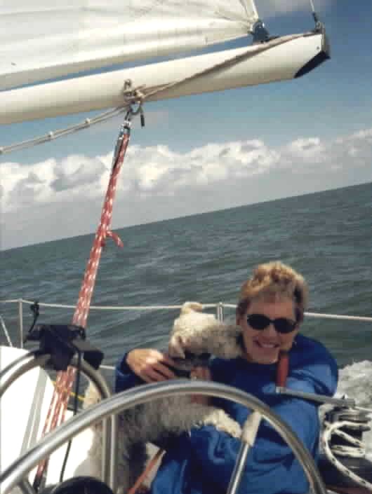

Advantage of an oversize Dave? Not sure as I have only had it this one season. And I probably sail less in a season than you do in a week. It is definitely better than the original, almost acts like a small drifter(which I have and used once this year). I have wondered if there is some way to pole it out? And I have not tried wing-and-wing. My boat sails so well on a reach that, since I am just daysailing, I go for an hour or two on one tack and then back. Why go slow when you don't have to? :) Picture is last sail of the year. Gosh I miss it.
