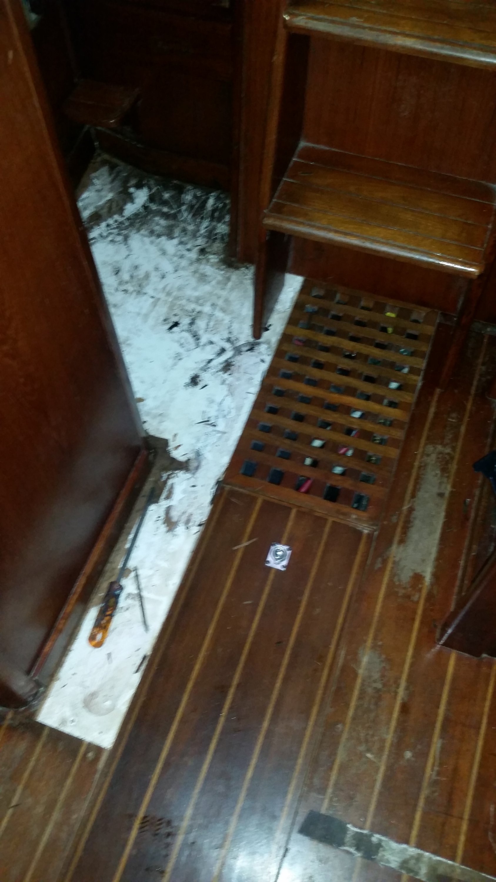

Correct, the shelf under the icebox leads to bad places. Behind the drawers and the stove and onto the cabin sole. The muffler lays on the same shelf. I had pin hole leaks and could not find the source for the longest time. On port tacks water would appear in front of the stove. And so you get this picture.

So the teak&holly floor is laid right on top of this floor liner, in contact with it? I can see the angled part of the fiberglass liner in your photo that corresponds to the same angled portion of the wooden floor. Very interesting...and a bit surprising, given the potential for water to find its way there. I have noticed a slightly soft spot in the sole, in that angled area...perhaps this explains it.

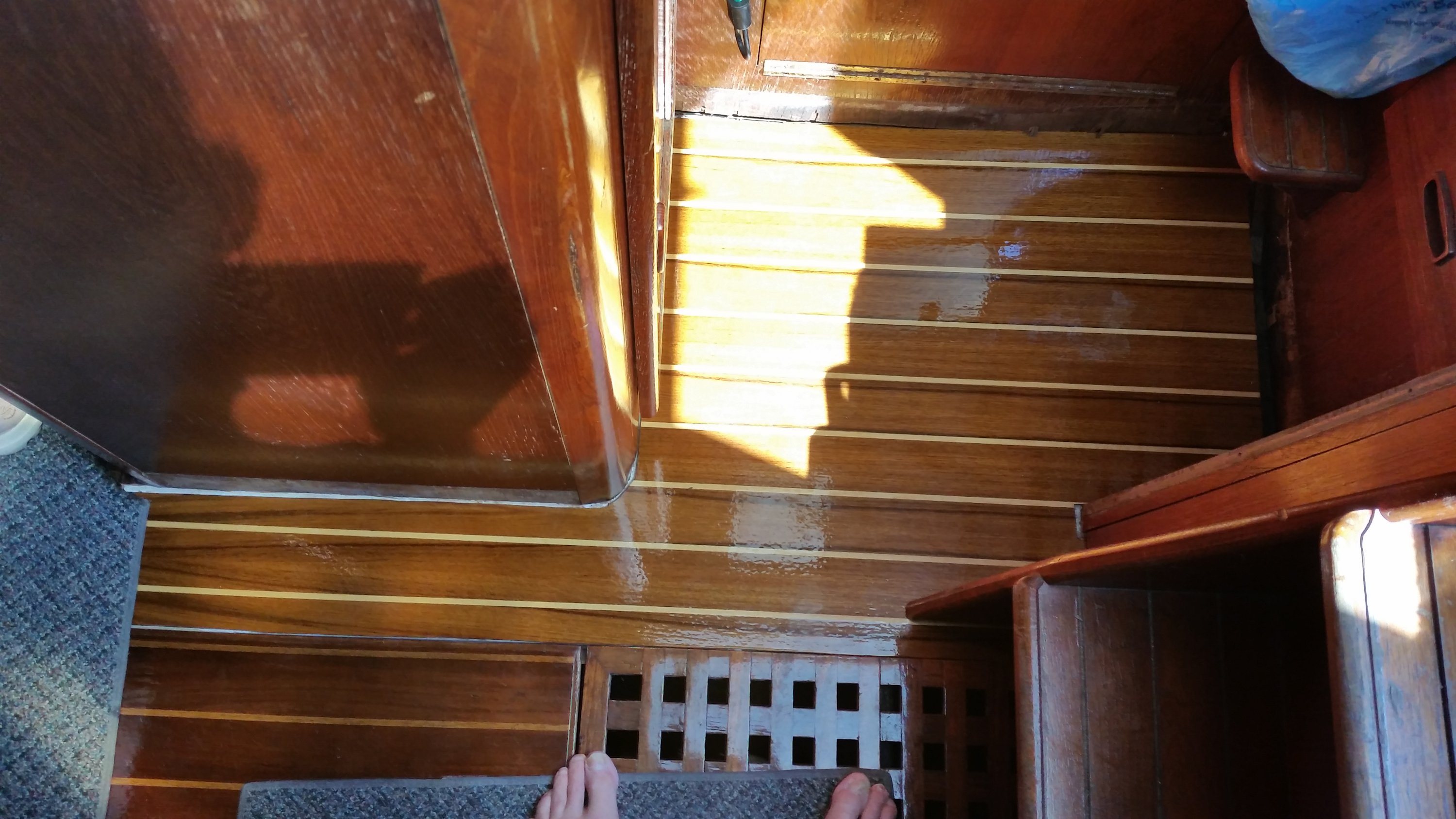

Correct, that angled part probably just lost its adhesion. Maybe due to water but could just be time. There is not a lot of adhesive holding the plywood to the glass. Here's the new piece before the baseboard was reinstalled. 20160601_114841.jpg Just noticed that I got my toes in the pic.
