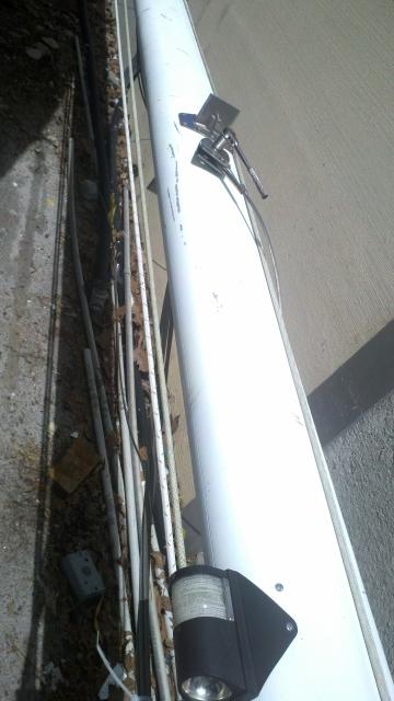

Looking at the Rig-Rite web site, it looks like the replacement spreader is Kenyon Spars SP4 Airfoil Spreader.
Does anyone have any experience with ordering a replacement thru Rig-Rite? The site speaks of variety of parts series used within any given model.
Is there more research needed to order the correct replacement for the rig?
How about mounting type for a 1980 37C?
As always, thanks for any responses.
1,085
Darn! I was just up the stick yesterday to fix masthead wind instruments. Also checked the cast spreader tips on the way back down...could have taken measurements while I was there. I believe Ed S is right - its most likely an SP4 section.
