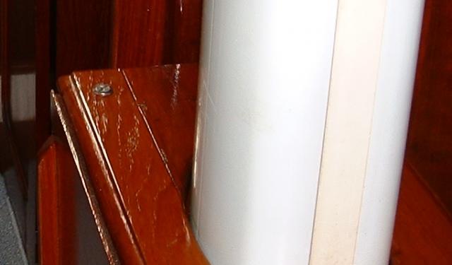

We removed the table by removing several bolts and screws. Maybe you can see from this picture (hope it uploads) there was a separate piece that could be removed so the table could slide away from the mast.
