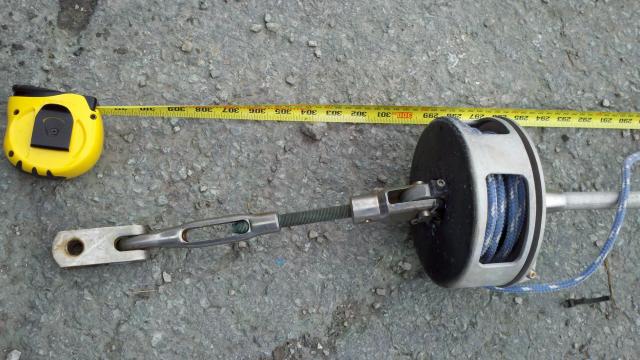

Having trouble trying to determine the exact stud to eye length of the new forestay. In replacing the old solid rod furler I see that the Harken furler with the standard toggle attaches right at the chainplate. In other words the turnbuckle is up inside the furler drum. I think that is way too low for our yankee foresails. Am I right?
In studying lots of pictures I find two, Blaise and Mark, where the top of their furler drums are about even with the lower pulpit rail. My Hyde drum is just above that rail. As seen in the picture that takes about a 10.5" extenstion. Most H37C drums seem to be even higher. Now Blaise races as a sloop with a deck sweeper so I am not sure that is a good comparison.
Given that I am somewhat constrained by my yankee's luff length should I go lower or try to duplicate the old? I wonder how I do that with the available hardware? You can also see from the picture that I cannot use the hardware that I have. It is not a real turnbuckle and would be non-adjustable after installation.

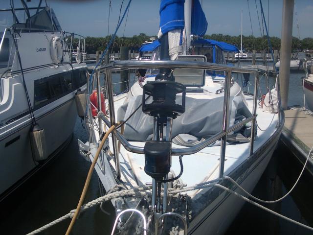

I have a Hearken cruising unit. Has 2 stainless legs that bolt to the pin, furler drum. harken Manuals show this clearly. I'm on Mary's computer so I can't get to my pictures. Will take a photo later and send to you.

Mary has photos. We are at Caladesi Island, so I can't reach my manual. Will liook at harken on line later, e-mail you tomorrow. Mine see more like 14" than 7

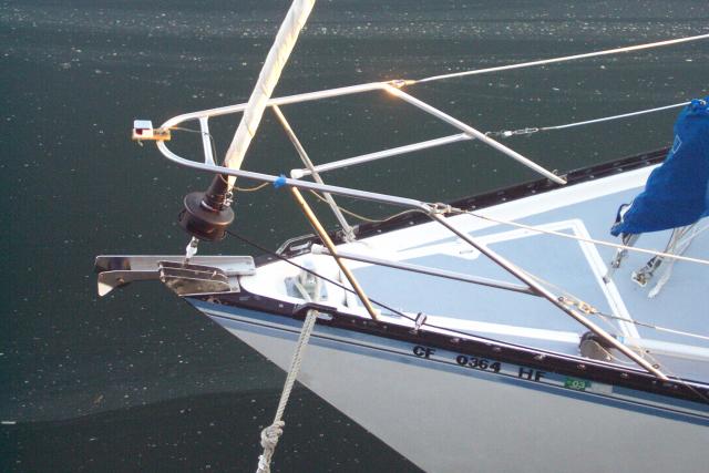

The yard that installed mine modified the pulpit. Since then we have a new jib that is made to go with that installation.
Jun 2, 2004
5,802
Thanks for that closeup John. Now I see how you are able to keep the drum lower. And you probably have a luff that is 6" longer than mine.

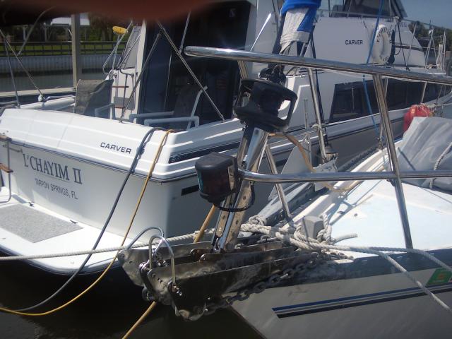

Got some pix on Mary's camera yesterday. There is a special Harken Pin with a shoulder and threads at the bottom, 2 allen head machine screws in each piece that fasten to the bottom of the roller.
I didn't put this one on, Chet P did, but I put one on another boat using the old forestay by feeding the extrusions over the swaged stud.

Those pictures really clear things up Bill, thanks. I can see how those link plates have multiple holes for shortening. I think I will bring mine down a hole or two to more closely match where my old drum sat. Ed points out that I don't want the swivel too close to the top. I think too close is asking for the dreaded halyard wrap.
I haven't read all the manual detail yet. But it appears that you can slide the drum up over the foil somehow. This permits adjustment of the turnbuckle while the forestay is attached, right?
1,483
Yes, you can slide the drum up. Much easiere on new ones than old, but you can do it with both. You can, if your head swivel is too high, put a keeper on the mast to pull the halyard in at a steeper angle, and keep it clear of the swivel.

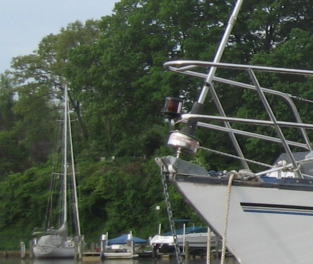

"In studying lots of pictures I find two, Blaise and Mark, where the top of their furler drums are about even with the lower pulpit rail. "
Ed- not sure if I'm the Mark you are referrng to but, here is a shot of my furler. I have a long cable that goes from the tack attachment on the drum to the tack on the furler as you can see in the photo. Hope that helps, if its not too late. I have been busy getting Illusion back in the water and moving in ( I think I'm going to like living aboard!!)
Mark
