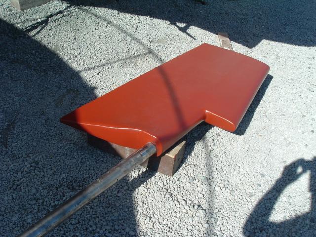

If you have remnants of the rudder it can be rebuilt. Chances of finding one from a salvage yard are not very good. Best bet is to dip into your 401K and order a new one. Foss Foam made the original and still makes replacements: http://newrudders.com/ . As Rardi points out we hang on the Cherubini Forum. But "Mid-Size Boats" definitely not, the H37C is a "big" boat. :)
Pic: my rudder rebuilt by Sailcraft in Oriental.

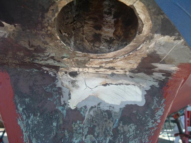

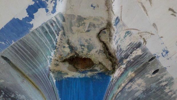

Rick, that is ugly! Is that the same spot as in my picture? A lot of Hunters have a fiberglass sleeve in the molded hole. Our boats seem to have a bronze sleeve. You can kind of see it in the picture.
P.S. I see that it is the same place once I made out the scupper outlet on the right.
Jun 2, 2004
5,802
Are you sure that the sleeve is not in there? Maybe just the bottom end is buggered up. Can't tell from the picture. You could measure the I.D. if we knew exactly what it is supposed to be. Somewhere here in an old thread I know the rudder stock O.D. has been posted. A call to Foss Foam could get you that number. I'd guess at 4". Blaise would know if he sees this. Problem is we are on "Mid-Size Boats". I'll look for the diameter and then ask the question over on the Cherubini forum.
