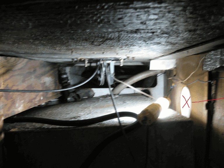

Hmmm...not quite what I was expecting to hear! I've included some photos to try to show what I'm looking at and why I'm confused. The tank just looks way too big for it to be a PO mod - how did he get it in there?
Photo 1: This is looking aft from the (empty) engine compartment. I added a red X on the right to show where the round access plate from the aft cabin is located.

Definitely looks original. Same Florida plate as mine. Same gals. Different location. But...I have an original Marine Air A/C compressor where yours is. Or I should say I "think" its original. Did yours have original A/C ?

FredV, mine is in the same location as what you have, centered behind the motor. Hull #3 and it is original, no way to get it in with the deck on.

OK, so it is the original tank. I assume the PO installed the other tank in the lazarette because the original failed somehow, presumably dirty and/or leaked. So now I'll need to consider options:
  • Remove the original tank - that will give me tons of room back there, but then I'm stuck with the smaller tank in the lazarette.
  • Remove both tanks and install a new one in a better location - that will presumably give me more room for other stuff, and larger fuel capacity, but sounds like it may cost a small fortune.
  • Fix the original tank - that will give me more fuel capacity, plus I could then remove the lazarette tank to gain some space.
