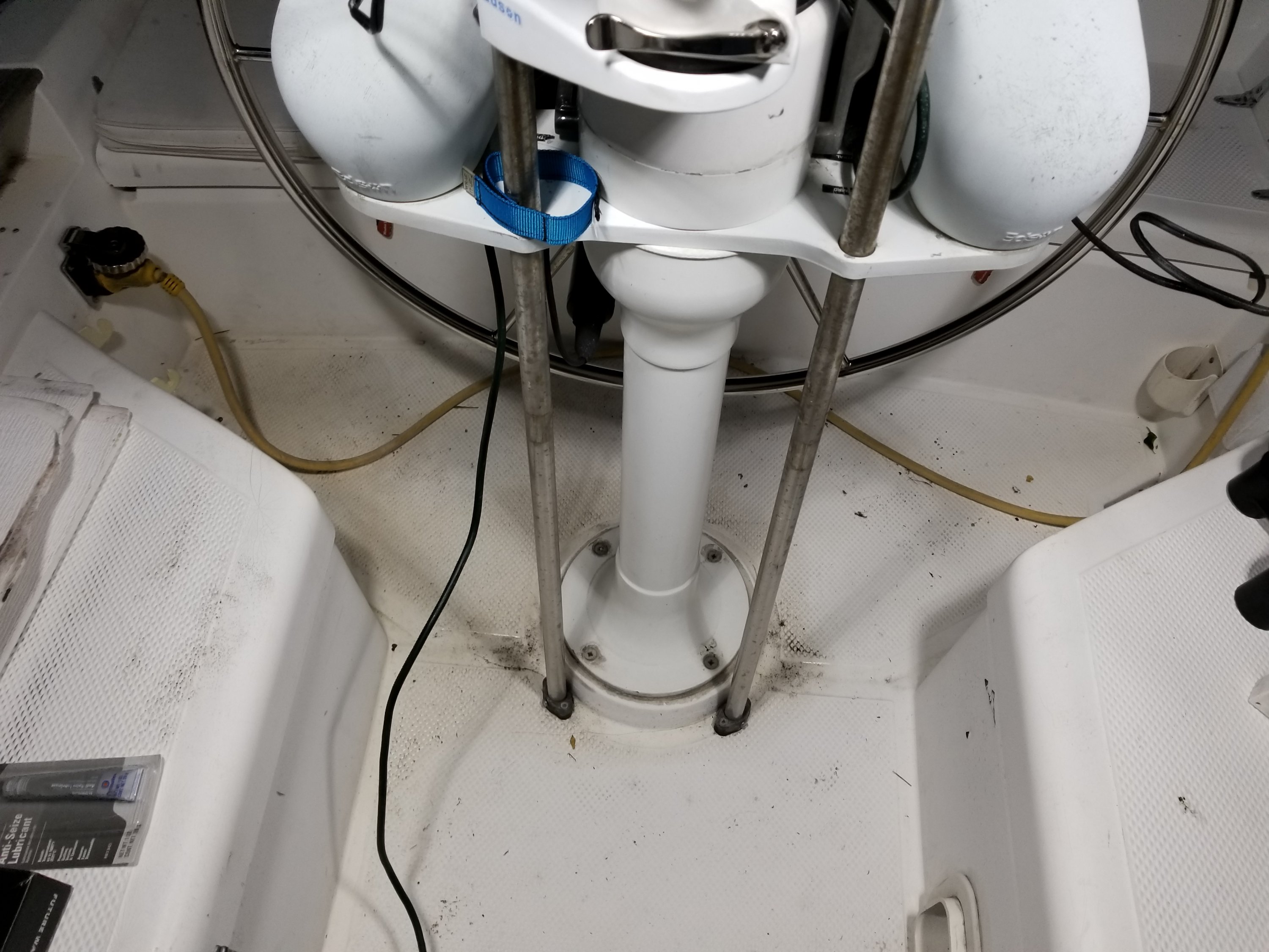

I am also having this issue. Mine are clogged every time I go to the boat. It makes it very hard to keep the cockpit clean.
As soon as I remove the plant debris (mostly palm frond leaf fragments and iguana crap), the cockpit drains quickly
Does anyone have any other successful suggestion? What size screen would you use?

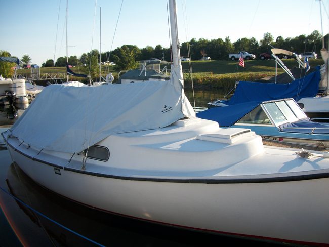

I like that idea of a cockpit cover combo. Any pics you could share?
Tom
jwing
Jun 5, 2014
503
ODay Mariner Guntersville
That is not my boat, but my cover was made using the pattern that Sailors' Tailor made for the boat in the photo. I had them add visored vents to the sides and the stern wall. High quality materials and workmanship. Good people to work with. I found that they do better at answrring the phone than replying to email. http://sailorstailor.com

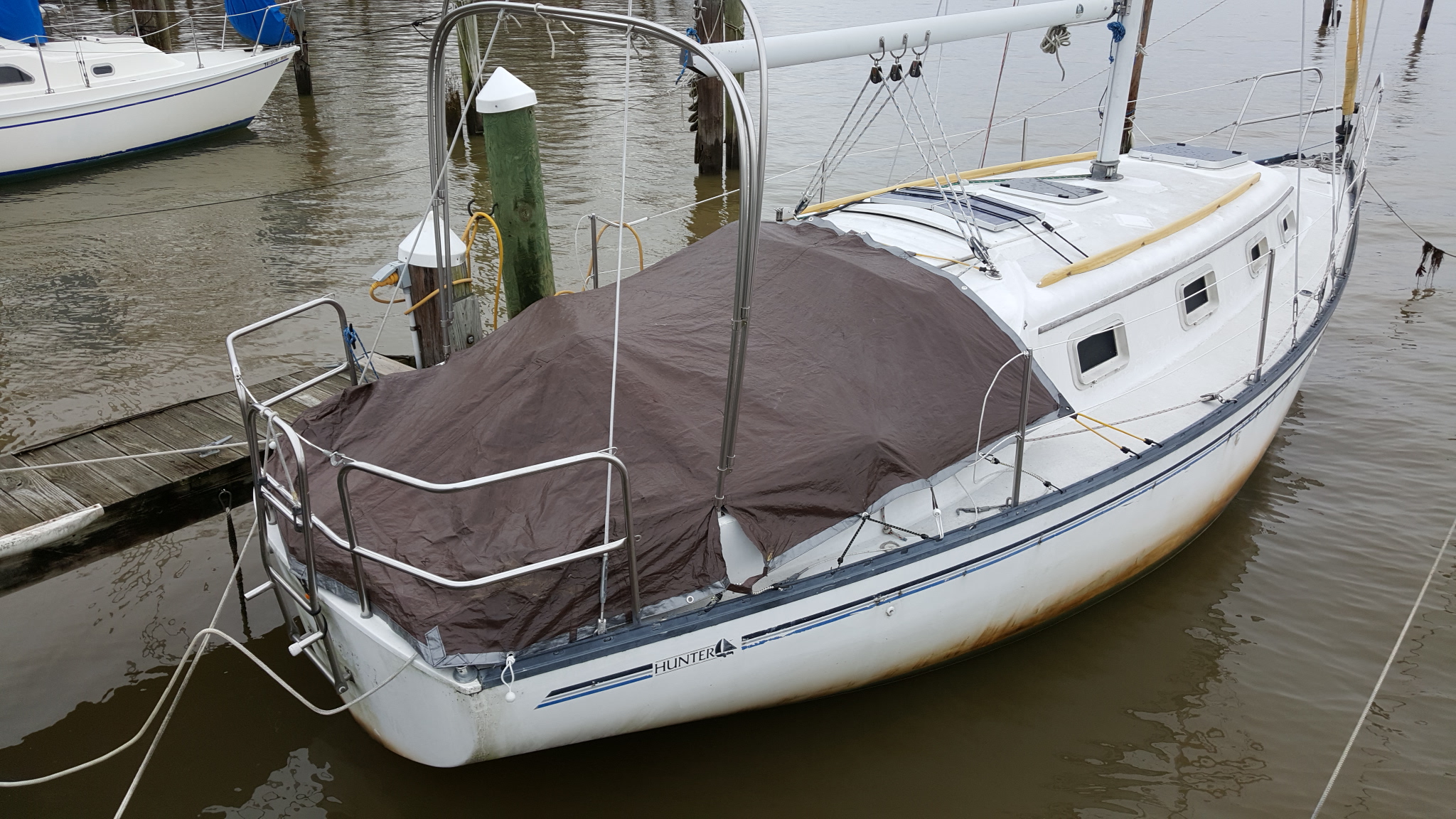

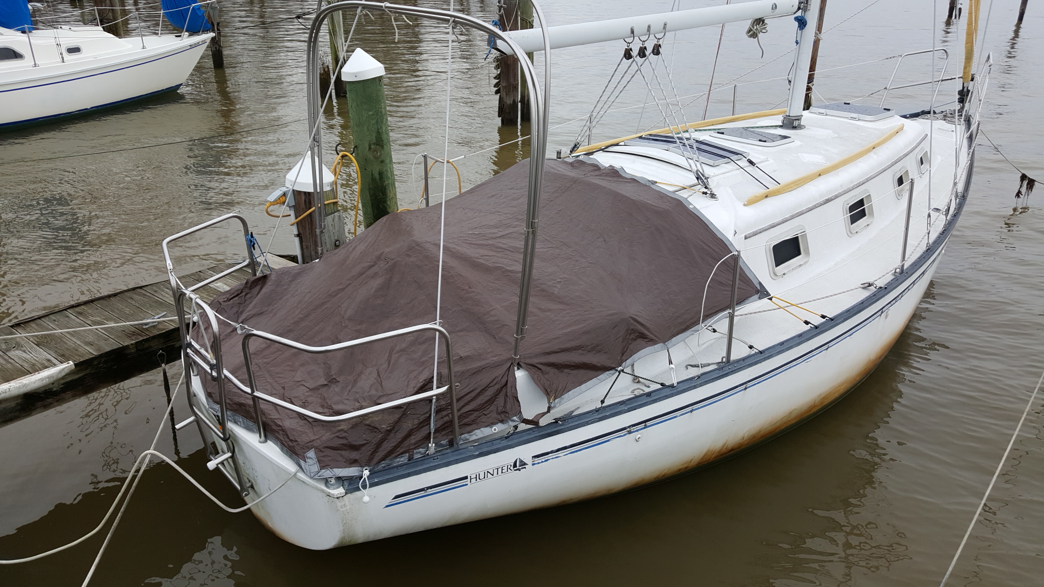

I put this together for myself out of old tarps, will upgrade it at some point after I've sewn other projects, but it works to keep the worst of the water & junk out. I sewed it because I didn't know any better, and then found out they make tarp tape that might be good enough to hold it together, but I'm not sure about a high wind.
I have little sink drain screens for the rest of the season, but you have to stay after them. I'm lucky in that I can stop by the boat on the way home and check on it.
