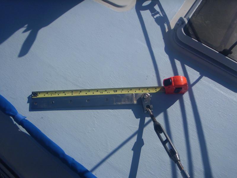

Hey guys, who has exact chainplate dimensions? I should have but can't find them. Our friend Angus found a bad chainplate on #075. I'm 074 so it is important that he rescue this boat. I remember that one or two of you had them made from 316 stainless. I also know that someone made the entire thing the thickness of the raised portion at the hole for the pin. That would make it 3/8" thickness instead of 1/4". But I do not remember the length and width. Pretty sure the bolts are 3/8". He is on one coast, the boat on the other.

Ed,
Width 1 1/2 inches
Thickness 1/4 inch
Bolts, 2 1/2 inches apart, each 3/8 inch
13 1/4 inches below the deck
1 1/2 inches above the deck
All material is the same thickness. Each of the six has a backing plate of the same thickness and width.

Perfect! Thanks John. I'll add that to the rigging detail in "Owner's Mods". Then I will try to remember that it is there.

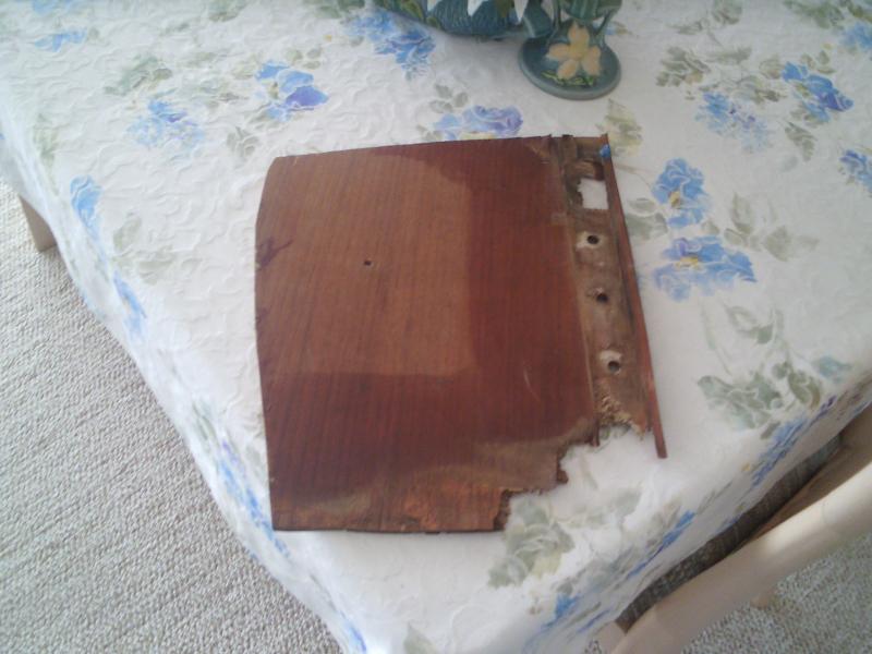

You can tell when a guy is married to a sailor. He's allowed to bring boat junk into the house. :) You're a lucky guy Bill.

It wouldn't have stayed there long. The guy who is going to fix it took it with him. I knew it was temporary. What's annoying, when we bought the boat, chainplates leaked (which I fixed/caulked), but the surveyor at the time we bought the boat made a big deal about the leaky area, and it was only a thin piece of veneer that was wet. Well, we are going to fix that and it will look as good as new.
