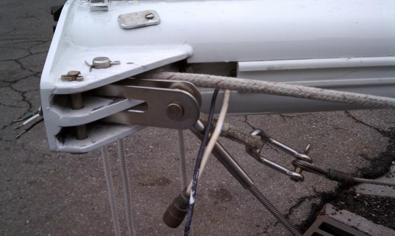

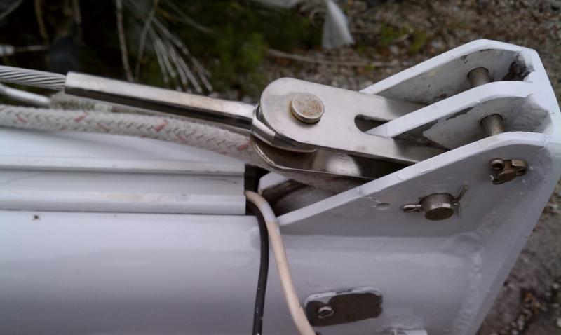

Does your masthead look like the pictures? Regardless I think that you have four sheaves, two forward and two aft(like I had to write that, duh). When I added a spare halyard and a spinnaker halyard I had to also add exit plates.

Ed thanks. I remember seeing yor pics of your masthead, but couldn't think of a keyword combination that would zero in with a search. "Mast" would have given just a few to many hits to sort through!
Yes, I think my masthead looks the same as yours. Will need to snap a picture with my new 8x zoom digital camera to verify. So four sheaves it is. But as you mention, the port two would need an exit hole to be cut at the mast base. Now I realize why my forward spinnaker/spare/3rd halyard is "sheaved" at the masthead by an external block... easier than adding a hole and new sheaves at the mast base.
