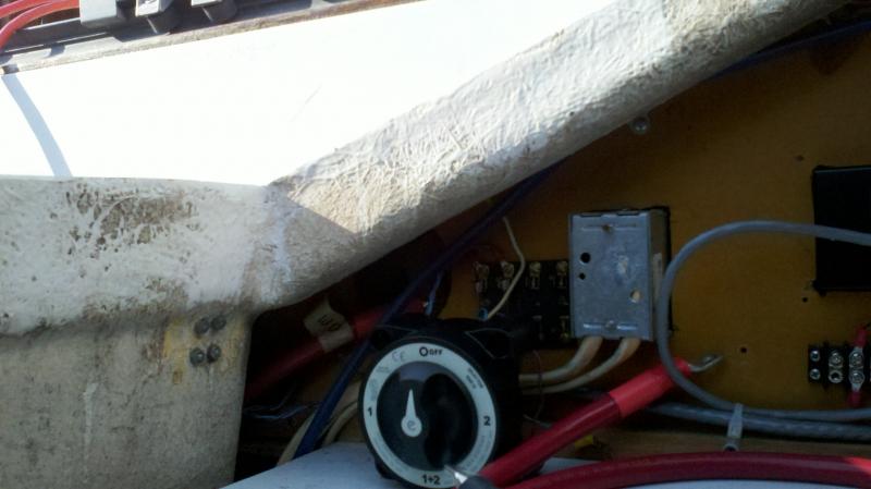

It was my intent to get a good start on the rewire with my new panel and 1/0 wire. Problem #1, the thick lugs meant my ground stud was too short for a lock washer under the nut. Problem #2, the hole where the wires go through the bulkhead is too small for two 1/0 wires. Problem #3, with the panel in place I have no place for my legs. So I can't get into the locker to access all the connections. Problem #4, even if the hole were the right size I could not get the new Blue Sea battery switch in from the back. There is not room between the lip of the locker and the bulkhead.

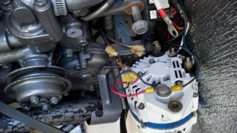

I was able to run the new ground through the bulkhead. I found a way to run the new wire directly from the alternator to the 12v bus. Now I have to put the starter and alternator wiring back together. I would like to remove the old wire from alternator to starter but it is in a conduit.

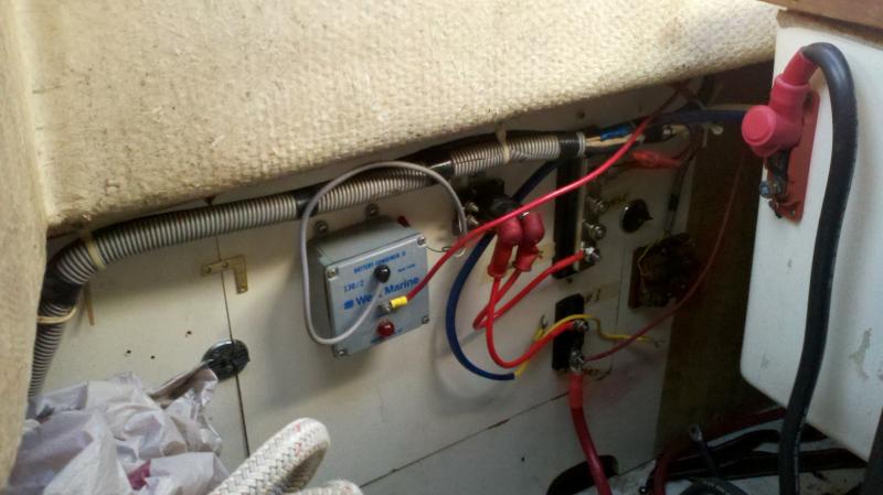

I also ran the new long 1/0 wires from the bilge up into the panel area. In the panel picture the blue wire is my refer wire. It goes to a breaker over the fridge. I'm going to like the end result I think.
