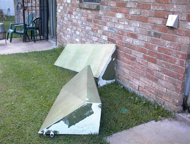

I am starting to think about tank replacement/repair. In Owner's Mods we have one water tank project: http://hunter.sailboatowners.com/in...&cat_id=38&aid=7108&page=article&mn=37-cutter . I also know that a Search will find some other ideas. Even Richard writes that he would probably do the other tank with epoxy when it gives way. As you can see in the attached picture the tanks have a very odd shape. No way you are going to find a poly tank that will give you anywhere near the same capacity. So repair or bladder or custom build?

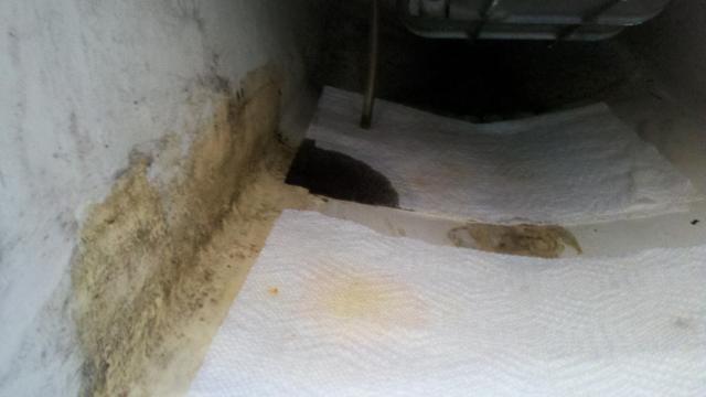

I always thought the same of our fuel tanks. Then I start to read of people having leaks in their aluminum tanks. And there is no way to see anything. My concern stems from finding some oil on the surface of the bilge water. Maybe it is related to the truck trip home. I also had some oil in the engine pan. So I put some paper towels under the engine(picture). That tube in the picture is well behind the spot and is water at any rate. That oil spot is under the oil filter. . . .I think.

Ed,
I don't know what your future cruising plans are, but if you aren't going offshore for a long time, you don't really need the capacity the boat has. My plan for when Midnight Sun's water tanks go is to put in a thirty gallon poly tank and a watermaker.
Jun 2, 2004
5,802
I think if(when) I find a water tank leaking I will replace both with poly. I want more than 60 gals for resale purposes. But the fuel concerns me most.
