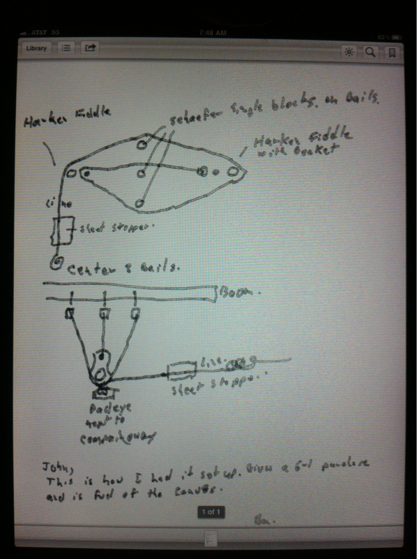

Has anyone used the Garhauer gear to move the traveler to the cabin top and how easy was the mod and mostly how robust is the unit.

Someone correct me if I am wrong. But aren't the booms different when comparing those made for mid-sheeting versus end-sheeting? Where the three new bales are attached how do you get the bolts through there without hitting the reefing hardware? And is the boom strong enough without reinforcement at the bales? Those questions are why I never considered moving mine. Along with the fact that I have more control with end-boom sheets.
1,072
Ed, I believe the boom is an identical Kenyon section on both older & newer H37Cs. The 3 bales (Schaefer on my boat, I think) are mounted on the horizontal centerline, maybe 20 - 24" apart. There are pieces of tubing that go inside of the boom for the bolts to pass through, to prevent crushing the boom section. The outhaul and reefing gear goes between the bale bolts and the top of the boom, as far as I can recall. Yes, it is fun to rig all the stuff inside. I had my boom completely apart many years ago because, when I purchased the boat, there were bird nests (swallows???) inside the boom and I could not get them out any other way!!!
