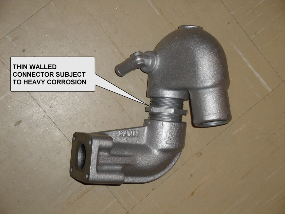

As shown on my mixing elbow after an internal inspection, all the parts are heavy cast iron with the exception of that screwed connector between the two heavy parts. Yours is slightly different. The connectors we have are just thin pipe, the weakest part of the assembly. The connector is plain steel and corrodes more easily than the other two cast iron parts. You've got to keep an eye on its INTERNAL condition.
Have it replaced and make a note to have it inspected in 4 - 5 years. Make sure none of those hoses connected to your model are pulling on the assembly.

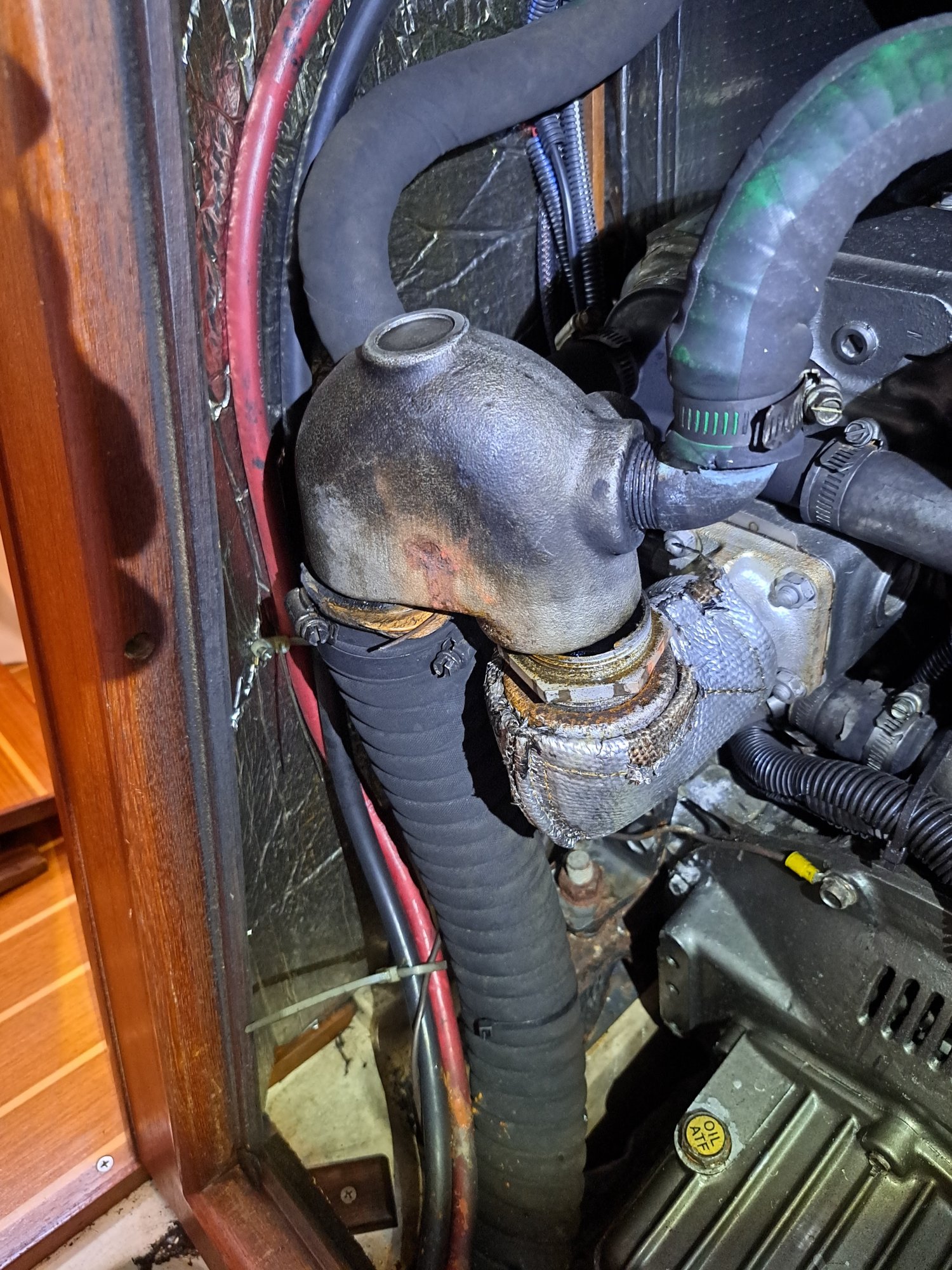

I had a similar experience. The threaded coupler broke as we were prepping to leave the dock. I noticed a change in tone of the exhaust and went below, smelt the exhaust and saw the water spewing out the manifold so shut the engine down.
I was able to easily remove the coupler from the manifold, so I ordered a new stainless elbow and coupler for significantly less than OEM Yanmar parts. It took less time to remove the broken parts and install the new parts than it did to clean up the mess made when the coupler broke, maybe 10 minutes total for the removal and replacement.

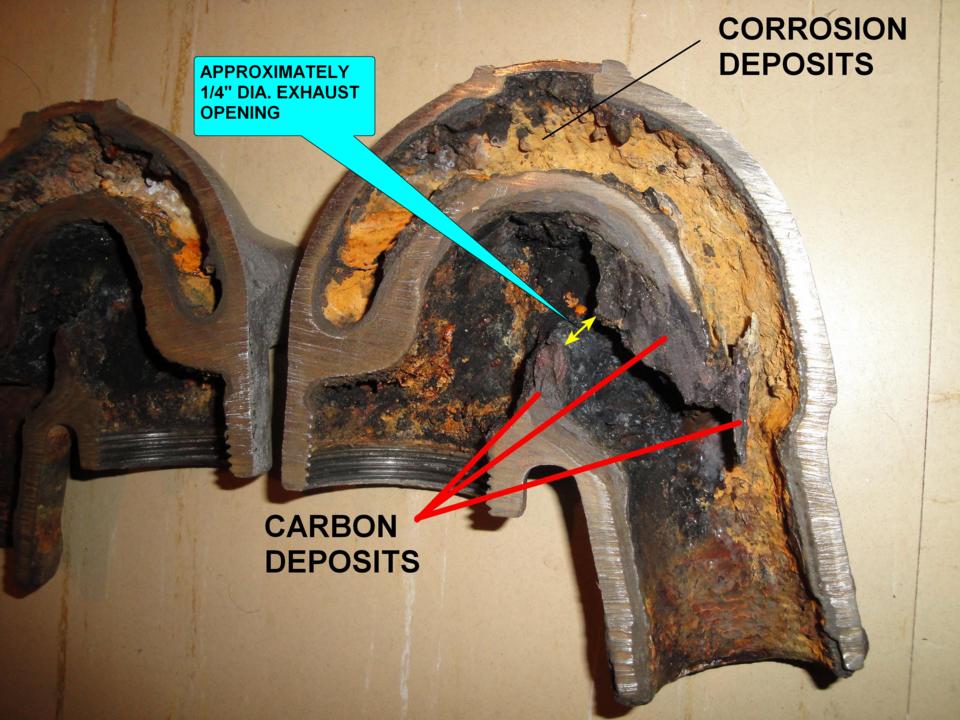

Below is another elbow I hacked open to give a better view of the internals in a less corroded condition :
The carbon deposits are harder than steel although I did once manage to remove most of the deposits from this item by leaving the mixing elbow submerged in "Easy Off" oven cleaner for six months. Unfortunately, the corrosion was so severe, particularly the dam where the hot gasses entered, it was put on display in my shelves of old boat parts labelled "never to be used." Went HDI SS after this event.
