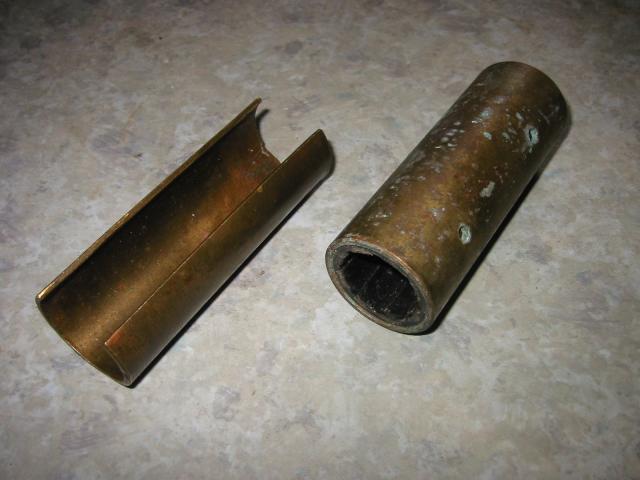

The cutlass was a blxxdy nuisance as the metal tube was so thin the bearing sleeve could not be removed without first taking the shaft out and then using a hacksaw and a screwdriver to destroy the original bearing. It also meant hard work removing the coupling from the gearbox end of the shaft etc.
Apart from the time and effort involved the yard's charges would have been considerable - and all for such a simple task and just because the builders couldn't be bothered to use a decent setup - or to save 2 cents?
After the second bearing replacement I took the strut off and had it bored to 1 1/2" diameter so I can now use the standard bearing as fitted to very many boats over the last 50 years.
Now I simply remove the prop, slide an old 1 1/2" bearing on the shaft which I have cut a 1" wide section out of lengthwise - and with just a couple if light taps the old one comes right out.
No need to go inside the boat at all.
See below for photos of my 'tool' and the old bearing recently removed.
Note a 'proper' wall thickness of tube to ensure fit which does not require a press to get it out plus two decent sized holes for shouldered grub screws to locate the bearing. Its called engineering!
